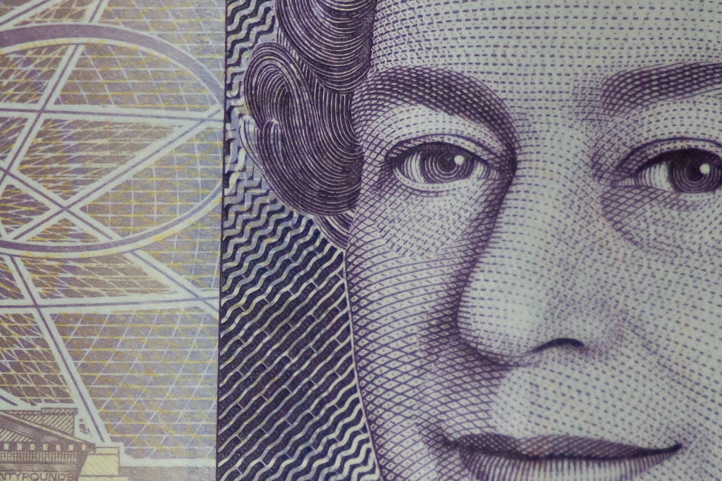

Attached is a 100% crop from a GBP20 note which I use as a test target. This was taken with the 120-300os with a Canon x2III TC attached from a distance of about 4m using a 60D with iso 1600, f6.3 and 1/200th second and HANDHELD.
I had the non-is version of this lens whch I did not like at all. The os version is much better in every respect, IMHO.
Looks ok to me !

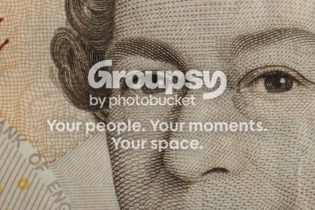

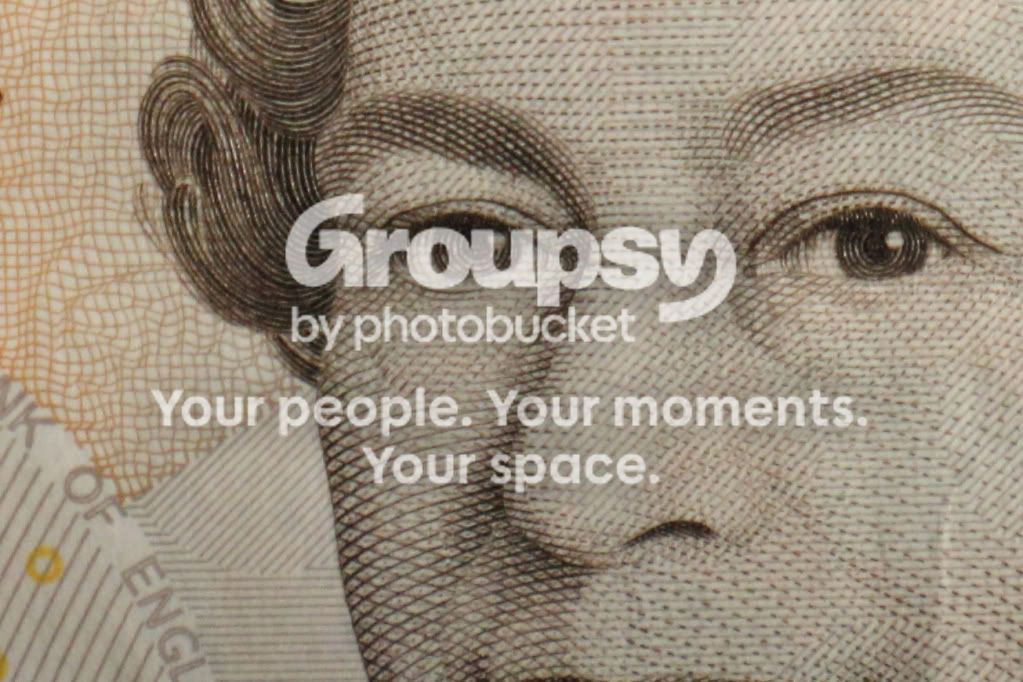

I just didn't think it was as sharp as I would have expected from my Canon 300mm. So I had a try at replicating the shot - Canon 300f2.8 + Canon 2x TC MkII. 1/180s @ f5.6 and ISO1600. There was quite a bit of variety in the shots because of handholding and this is the best...
If you look at the single hairs right on the edge of the queen's face I think you'll see quite a difference. I'd be really interested in seeing a repeat of your test without the filter, on a tripod and with a flat note (I think some of the fuzziness may be because it's crumpled).

Crumpled note, yes, shot with a x2TC and not a x1.4 and this image was genuinally chosen at random so I do not know whether it was the best of my efforts as I did it in a bit of a rush. I'll repeat the test next time I get half an hour spare and post the results.
Thanks for the comparison with the C300.
Hi Frank
Whoops! Yes, mine was with a 2x as well - it's in the Exif.
Yes there's definitely a wrinkle in the note on the LHS. That'll explain quite a bit of the softness.

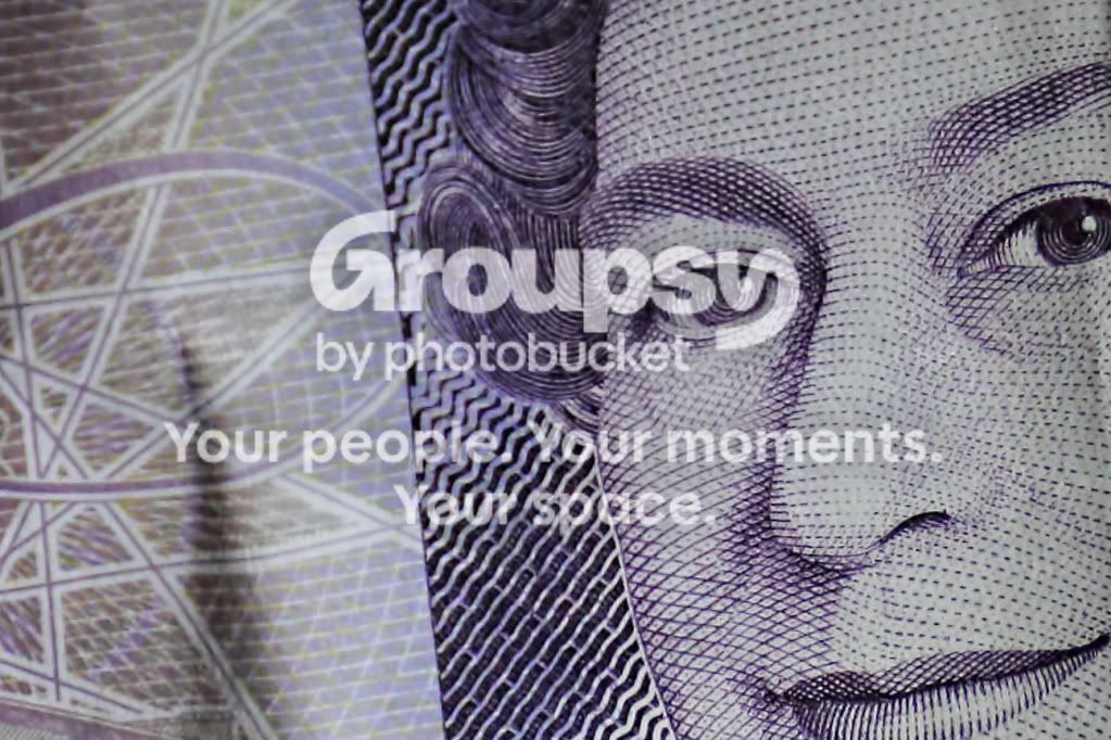

Sorry to compare apples with oranges a bit. Have been to Tescos and now only have tenners left.
Anyway, below are two images of a tenner taken with the 60D at iso 1600 and the 120-300os at 600mm f6.3 handheld. Please note, this is a straight RAW to jpeg conversion with no sharpening whatsoever or NR applied.
Top is with filter attached, bottom is without.
You can make your own mind up about the test used and the result !
Personally, I think this test shows the Siggy is possibly not as sharp as the Canon 300 with TCs attached when shooting targets and loooking at 100% crops but I doubt you would see much differernces in field shots.
