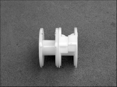

I’ve been having “reel” ;) difficulty getting 120 film onto my reels recently. 35mm goes on easily but at some point 120 just gets stuck. Is there an alternative for a Paterson tank or any modification I can do to the reel? I have the multi format that does 35mm and 120
I can't get on with the Paterson reels with 120, as the lead in tabs are too narrow. I have AP reels that came with my AP tank (but still work in a Paterson system) that have much wider tabs.
This is what I mean, I don't think the reel is an AP one but it's the same style.

Also need to have a look at those AP/Kaiser reels as they look very useful with that larger lip.

Reels with wider tabs made home developing significantly better - they are a good investment.

The Kaiser reel, which I think is the same as the AP reels, arrived the other week and it is so much easier to load 120 than the Paterson reels that I have. My blood pressure levels are now only slightly raised (trying to cut the film from the paper whilst retaining all of my fingers).
