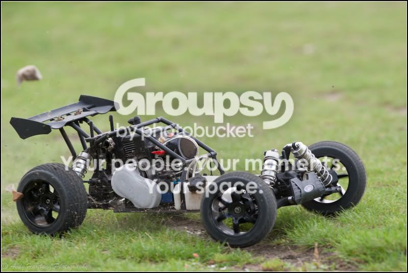

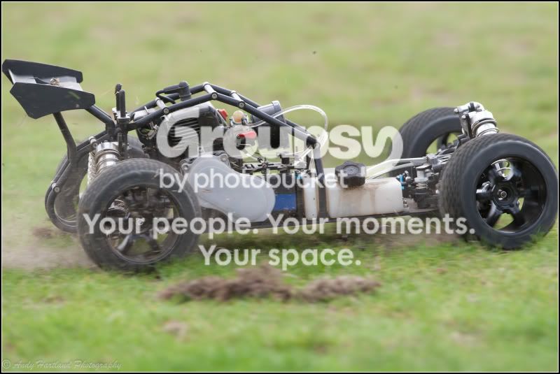

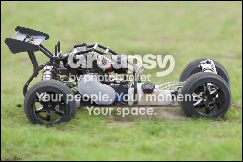

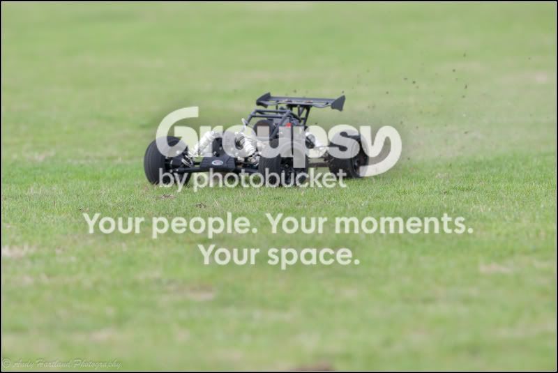

Went out today and put it through it's paces with a very hard subject to track, an RC petrol buggy :thumbs: Now I didn't expect this to be 100% perfect as this was a stupidly fast object to track but there were a lot of misses. Now some I am quite happy to say were operator error, ok, quite a few actually but I though this sequence was interesting as it obtained focus lock, then lost it and then regained again. Expected AF performance?

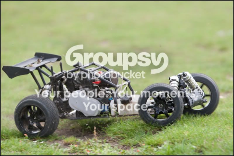

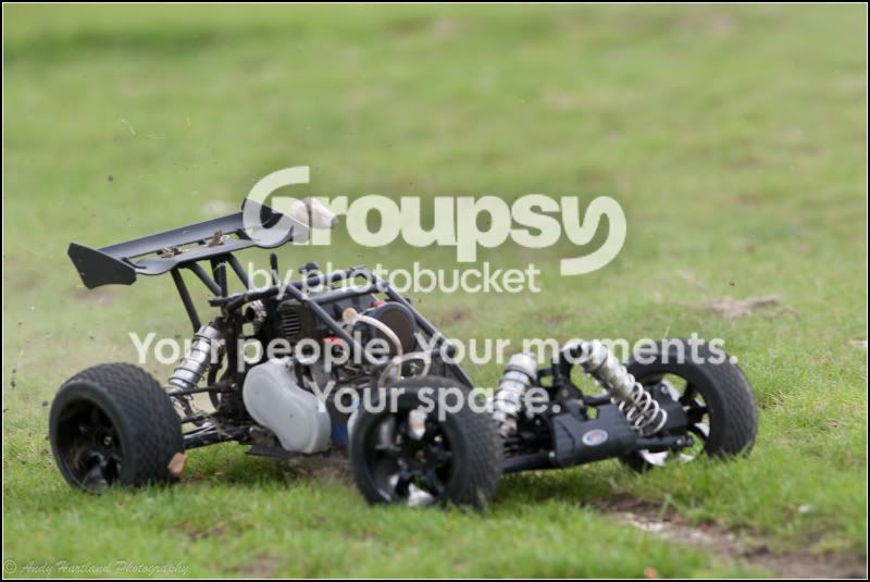

Plus I had quite a few what seemed like front focusing, couple of examples;

Andy, I think the focus problems with the RC car (even though this looks like a 1/5th scale) are due to fast changes of direction, also as it moves around the frame the camera will find that what it was focusing on has gone and so needs something else. Give it a bash on something more stable (real car, runner etc) and see how you go.
Yes this was a tough test to be honest, not helped by my lack of skill and knowledge :lol: It was totally unplanned and I went to take pics of aircraft but when this came out of my mates boot I thought this would be ideal as a workout. I think with a few setting changes like winding the shutter speed down from 10fps to 6 or 7 might of helped. Next time I will note which series of shots I have which settings enabled so I can review properly. However I have a better understanding of the custom functions now so will be better prepared next time.
The shots I took of the rc aircraft on the day all came out well so I think I will be happy with the 1d3 performance here. I want to get over to Wales and the Mach Loop asap to try it out on some proper fast moving subjects :cool:
I started off with it on one below middle and then set it to the slowest whilst trying to tract the buggy. There were a lot of cones that were getting in the way and by turning the tracking speed down it really helped keeping the AF locked on the buggy :D
Ideal, I usually keep mine on the lowest or 2nd lowest and seems to be about the best.
Thanks Mark, does seem best to slow the tracking down a tad :D
