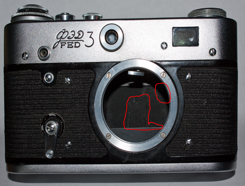

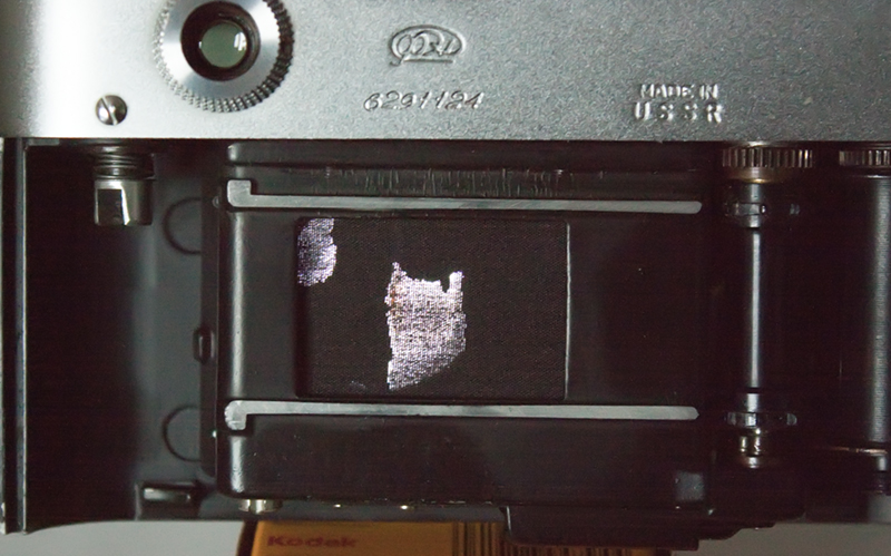

My Fed4L sadly is now resigned to be an ornament. I recently got it out for a lookover to find that although the back most blind on the shutter is okay, the inner blind is shot and breaking up. Thats my saddest thing as it was the first REAL camera my Dad got me for my birthday when I was about 12 and now I'm 50 and he's no longer around :(
Is it the actual fabric of the shutter, or the rubberised paint flaking off...
I had the latter happen to my Fed3 and sorted the problem with the application of some black latex based fabric paint.
Film Side by The Big Yin, on Flickr
This shows the state that the shutter had got into - all the missing rubberised paint was actually sat inside the camera :(
when you looked from the lens side of things, you could see where it had flaked away
Lens Side by The Big Yin, on Flickr

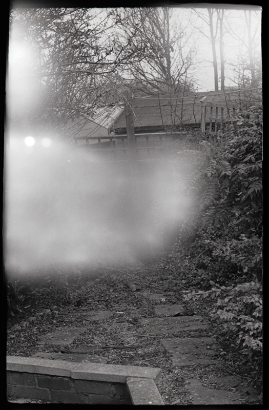

I sourced some black fabric paint from fleabay - this was the stuff II bought. I simply removed all the flaky paint (carefully, so as not to damage the underlying fabric) then applied a thin layer of paint. 8 hours later, I repeated the process and shone a torch into the body cavity to check where, if anywhere needed further paint. Two or three small pinpoints of light remained, but were sorted with a further dab, just in the offending areas. It's a matter of applying enough to keep it light tight, without leaving the shutter so thick and inflexible it affects the shutter speed. 10 minutes of faffing, and 3 days of patiently waiting for the paint to dry thoroughly and my FED3 was back to normal. Shutter speed seems about as accurate as FED's get, and there's no trace of lightleaks from it...
Pre-Fix Test Shot...
Fed3 - Test reel - frame 30 by The Big Yin, on Flickr
Post-Fix Test Shot...
HP5_2010-03-24_005_800px by The Big Yin, on Flickr
I've only shot maybe 3-4 rolls of film since fixing this, but everything is still intact - i've just shone a light into the camera before typiing this, and there's no traces of light leaking :)
