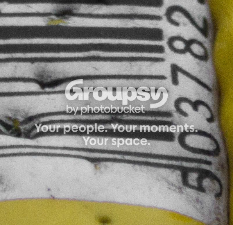

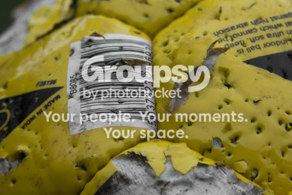

Got back from my holidays and now that I have both the Canon 2x III and Kenko 1.4x DGX I thought I try them together on the 600mm.
NOTES:
1. The combo reports the correct EXIF (1680mm)
2. The combo Autofocuses on the 1DIV even though the aperture is f11! (this has always been the case with the DGX TC's, they report the correct EXIF AND AF on any aperture given there is enough light).
Shot taken at low light (4.11pm) 1/30", ISO3200, f13, handheld
Shots below is the full frame resized to 1024x768 and an 100% crop.
Levels tweaked BUT NO SHARPENING has been done.

I was resting my right elbow on my chest and, admittedly, I took a number of blurry ones before the sharp one came along :D
Was too lazy to set up the tripod but will do that very soon and take some more :thumbs:
