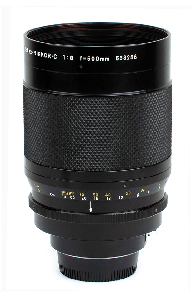

I've got my hands on a 500mm f/8 Reflex Nikkor-C - like this one in the picture below.
Can anybody tell me - or point me to a source that can tell me - which Nikon bodies this is compatible with? It fits on my D70, obviously, but the camera doesn't seem to know that the lens is f/8 and there's no way of telling it - so getting the exposure right involves a fair bit of guesswork. (And chimping!)
Thanks in advance.
Not my picture - linked here for information purposes. © Roland Vink
Thanks in advance
