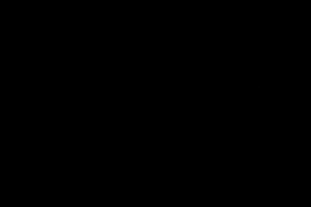

Here is my 5Dmk2, 30 secs, ISO3200, lens cover on, no cover over the eyepiece, room temperature
IMG_4710.jpg by arad85, on Flickr
im gona take it in to be looked at as they still show majorly with noise reduction on. its still under the extended warrenty- only problem is its with jessops :/
does anyone know if the warrenty will be covered bysomeone like H. Lehmann Ltd who are a canon authorised repair centerthats not far from me? and will be a hell of a lot more useful than my local jessops store
BTW, that's with long exposure noise reduction switched to OFF and high ISO speed noise reduction switched to Standard (i.e. the default settings). Post one of yours with the same settings.

Seriously though, do the lens cap test. Long exposure, lens cap on, high iso.
See what you get.
