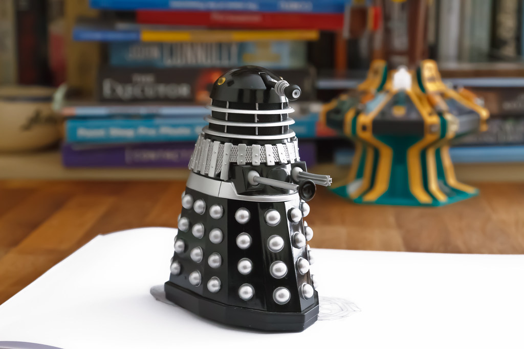

My method was for all ISO shots to be taken at f5.6 & 1/60th secs and so my thinking being that 1SO 100 would be 4 stops underexposed and as I increased the ISO it would start to bring the exposure back into line, and in a sense I didn't see using ISO 12,800 as underexpoing by 11 stops.

I wanted to start 4 stops under exposed @ ISO 100, and then by 1600 I would have a 'correct' exposure, and then 3200, 6400 and 12,800 were over exposed (ETTR) so I could then pull it back down again in LR3.

ISO 12800
The only thing is that if you are at ISO 12800, you aren't going to be ETTR.... The only time you will use that is because you are fighting for light, so it's going to be underexposed.

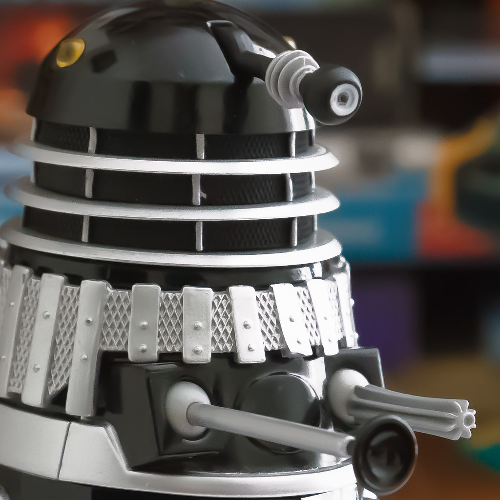

Unfortunately it's still too small. Your 1024 x 683 image has had 96% of its pixels thrown away. So you've thrown away most of the noise. The only real way to compare noise is to look at it at the pixel level. So one needs to show 100% crops and pixel-peep (although do make sure you wash your hands afterwards).
Here's an ISO6400 image with no noise visible...
But zoom in to one part of the image and the noise is definitely there.

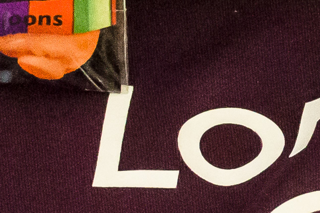

Here's a crop of 12,800

The dynamic range is also gone here....
Yes, but this is pulled back from 3x overexposed. The question should be if the exposure meter says it's 1/60th at f5.6 at ISO 1600, would you choose ISO 1600 or ISO 12800 to shoot the picture?

Look at the 100% crop. It looks very cartoon like and has no smooth changes between the lettering and the colours on the background. Also the cellophane doesn't look natural. The sensor is unable to pull the gradual changes in colour out from that, descending into noise. It looks fine downsampled, but at 100% it's not brilliant.

You may want to dismiss the numbers, but the 100% crop is still poor quality and has limited dynamic range in the colours :shrug:
