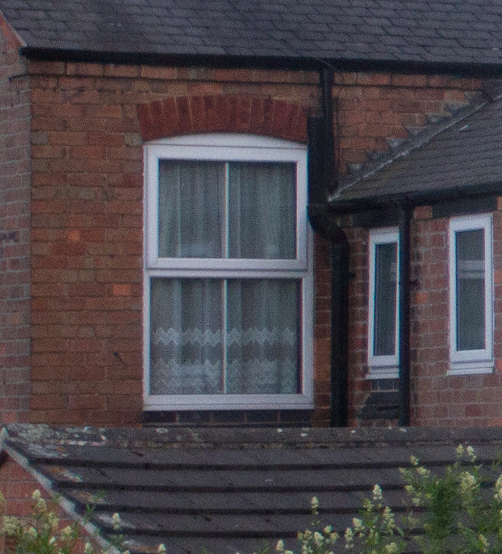

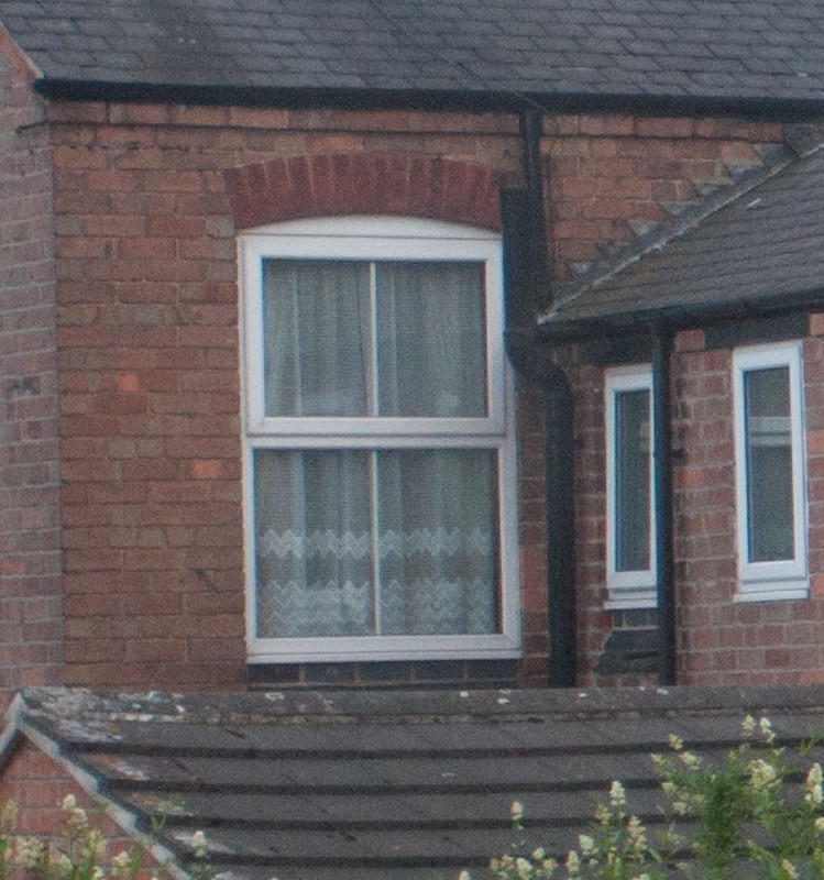

I got a second hand 1DmkIII a few days ago and have been deciding which out of that and my 7D to keep. I was just doing a quick very rough test this evening of the two and came up with the results below.
Both using the same settings on both cameras. No processing other than 100% crop then convert to jpeg in CS5.
7D
1DmkIII
As I said not a very good test but the 7D image seems to show more detail and the colours look more realistic. 1DmkIII seems to be a bit softer than the 7D.

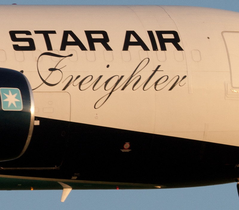

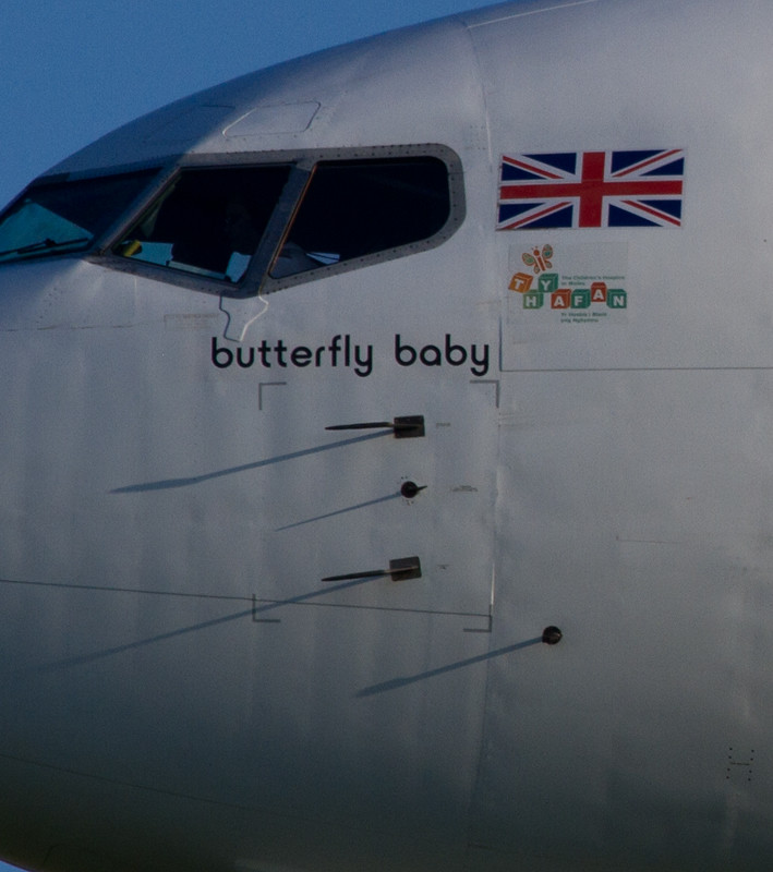

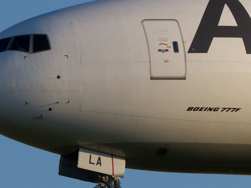

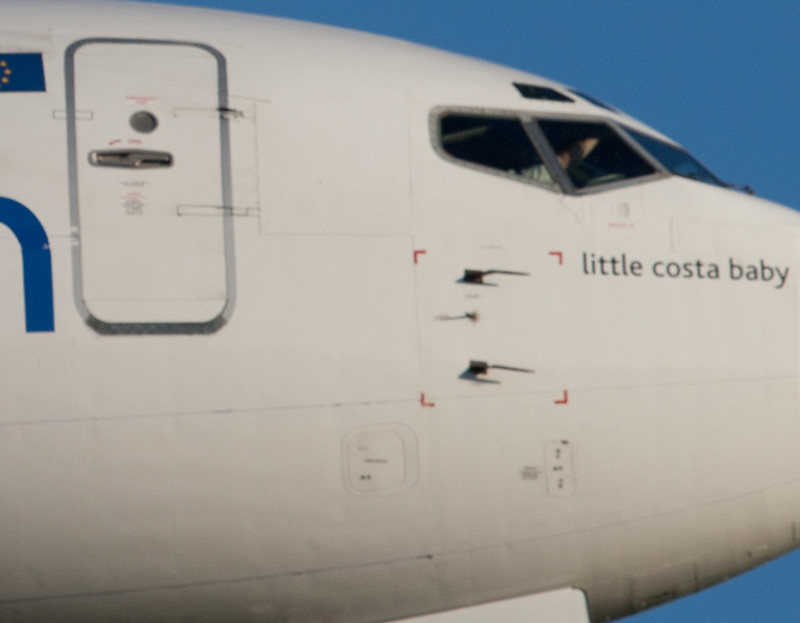

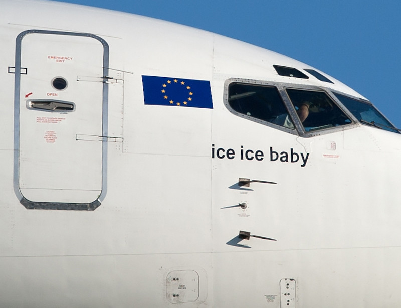

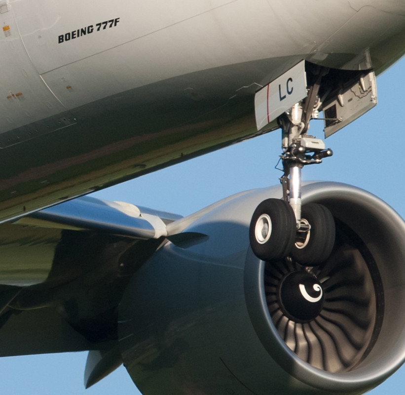

These are examples of my aviation shots. All are at shutter speed of at least 1/400 so blur should not be much of a problem. All are 100% crops.
First set are from the 1D.
Not the Ice Ice Baby letter are a bit blurred.
In same shot burst (high speed) as the above image.
This one seems pretty sharp.
Start Air titles seem sharpish, but Freighter ones seem blurry.
These next two are from my 7D with same lens, settings, shutter speeds etc and very similar weather and light.
The ones off the 7D just seem much sharper to me.

Andy, these can't both be 100% crops as they're both showing the window the same size. What you need to do is open the file from each camera at 100% and then crop a section from each of 800 pixels or less ( for showing at 1:1 here)
The window should be considerably bigger at 1:1 from the 7D.

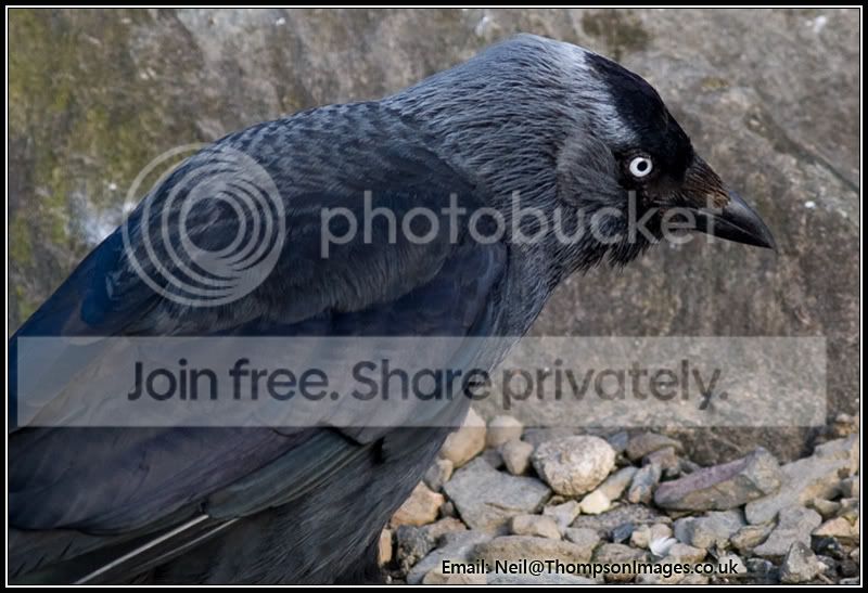

Well the 7D does appear sharper, but much as I'm a huge fan of the 7D and to be fair to the 1DMK3, both of these images would benefit from a sharpen, and I'm sure they'd both produce acceptably sharp prints at A3 or larger, but you don't want to confuse sharpness with pixel resolution, where the 7D has a massive advantage when viewing the images at 1:1 .
The following images are both 800 pixels crops from your full size (1:1) versions on Flickr.
1DMK3
7D
This should be quite a dramatic demo of the real advantage of the 7D for wildlife photography. Imagine the blue car is a small bird and the advantage is obvious.
That same advantage becomes a disadvantage if you want the wider FOV of the 1DMK3, so it's really up to you to decide what you shoot most and make a choice based on that.
Or just keep both! :shrug:

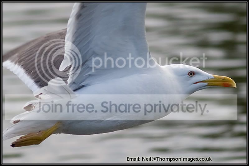

Heres a few 100% crops from the originals (http://www.flickr.com/photos/thompo5015/sets/72157624166843545/) i shot of BIF for you. Shot in AI servo, i think i used ISO400 and center AF point shot with 300 f4L (not IS) and no micro adjust applied. May have had the focus sensitivity turned down to keep it tracking the right bird.
First is not sharpened, 2nd is USM, 1.3px, 68%, threshold 1px
