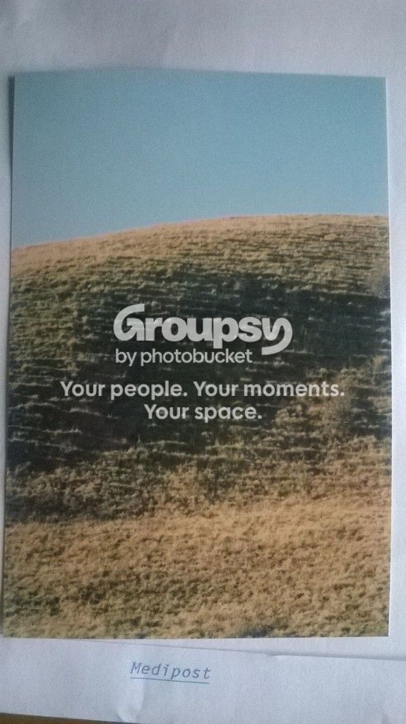

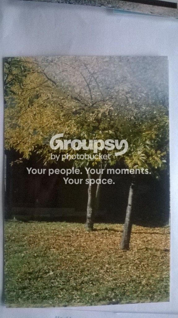

Hi.... If you post a shot we might be able to say what is wrong and why you are disappointed.....there are very few crappy 50mm lenses around from all different makes as it was a common lens so would be surprised if the problem is your Chinon.
The white "light" in the corner is what worries me. I am afraid is the light seal that leaks.
This picture however doesn't have it... (it was taken with a different lens)
Colours are very grainy, but I was told it's because the film was well beyond the use-by date
Well I see what you mean h'mm with two different lenses...the light leak is not usually a problem as light seals are easy to do yourself..and the shot with the leak could be because the sun was hitting the right spot on the camera where the seal had deteriorated. The lenses are not showing their best, were they wide open as I can only get the first shot fairly sharp in Photoshop but the 2nd can't do much with it.
What you will have to do is get a roll of Vista from the Poundland shop (for £1) to see if the old film was the problem and go from there. Let us know how you get on.
I don't think that is from a light leak. If the seals are rotten, then light usually travels through the film from the rear, substrate, side. This exhibits itself as a yellow or orange streak on colour film. Maybe it is caused by flare or an internal reflection?

The first example looks a bit like flare, perhaps an un-coated lens with sun on the front element?

The top review says "My copy of the Chinon 50 mm f 1.9 is fully as sharp as the Chinon 50 mm f 1.7 at least for situations where there is no major source of flare. It does not claim to be Multi-Coated, like the 1.7." Another mentions a con: "low performance at wide open aperture only suitable for soft portrait photography", however other reviews (including that last one) also praise the lens. But if not multi-coated it will be more susceptible to flare. Keep the sun off the front, either by shooting away from the sun, or use a hood. As Brian says, try some Poundland Vista 200 for your next set of tests to keep costs down...

- ChrisR: yes, the lens is a Chinon f1.9, so the not coated one. And looking back at the pictures with the white flare they all share one thing in common, the sun at around 90° to the direction on the lens! So, it might be flare.
