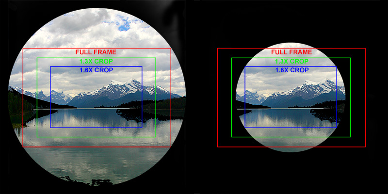

The same lens will produce the same image irrespective of the camera it's mounted on - lenses are stupid that way. The camera won't change the image in any way either; all that the camera does is record less and less of the image as the sensor size goes down.

A Lens is a lens is a lens.... does't matter what size 'sensor' it projects an image onto, for any given camera-to-subject distance, and aperture, 'on the lens'.... that image will be the same.....
ALL that changes with the sensor-size is how much of the image area projected onto the sensor, by 'the lens' the sensor captures.......
will it be like the following?
Apply the above.... remember the lens projects the 'same' image onto the sensor, so with a smaller sensor, you just capture less of it, and because you have 'cropped' a smaller section from the image projected by the lens, when viewed, IF you enlarge that smaller 'section' to the same frame size as you would the larger area from a larger sensor camera.. err... the littler 'bit' captured, has to be enlarged more, so 'looks' bigger, as if you had used a longer lens to take it with.... but you didn't.. your sensor just recorded less area of the scene the lens you used projected, and you enlarged it more in post-capture.

This appeared on TPF years ago, can't remember who originally posted it :)

On full frame, you'll see 300mm; on 1.5x crop you'll see framing equivalent to 450mm, and on 2x crop it'll be 600mm equiv.
Now to see what that looks like in practise, go to a focal length simulator and input the numbers. There are a few simulators if you google, like this one from Sigma https://www.sigma-imaging-uk.com/focal-length-simulator/
