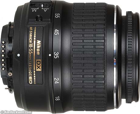

Don't want to sound too negative but a polariser can be a bit of a pain with the nikon 18-55 kit lens. Because the front element rotates when you focus, you effectively have to nail your focus before adjusting the polariser. It's very difficult to adjust the polariser without knocking your focus out because the focusing ring is right next to the filter and it is quite loose so very easy to move.

I assume you're referencing my post regarding the rotating front element? As stated, I wasn't specifically dismissing CPL filters for lenses with rotating front elements, just the particular lens the OP was talking about. The problem isn't particularly that the front element rotates but that the focusing ring is right next to the screw thread, offers almost no resistance to movement and si easy to knock. When you're trying to look through the viewfinder and adjust the CPL at the same time, it is a serious challenge not to knock the focus out as well. Been there, done that, gave up as it was extremely frustrating.
This is the lens in question. Look how close the focus ring (the small knurled ring just behind the front element) is to the front screw thread!
Yeah it was exactly the same story with the 18-55 canon kit lens I was using, it didnt bother me personally but I guess the specifics of the resistance of the focus ring could make it more problematic!
