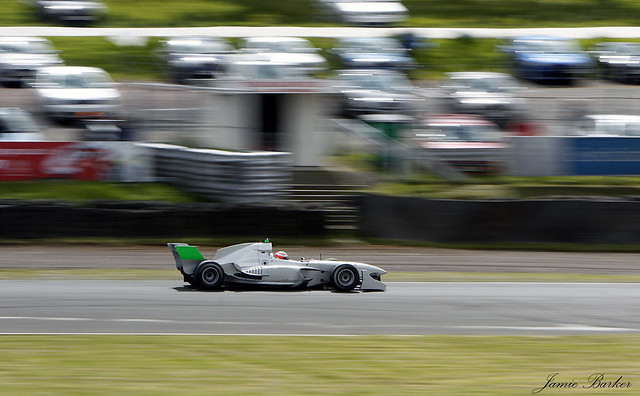

One or two of mine
Well looking at your pictures, I am not sure you need any advice, No 1 & 2 are very good, not sure about no 3, I shoot motorbikes and i use 1/60th.

#1 - The only nitpick I would have is that the numberplate/badge on the front aren't sharp, but that is seriously tricky to nail on panning shots anyway.

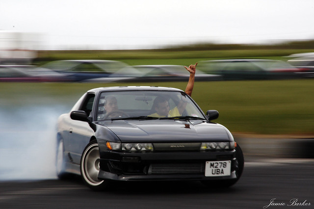

#2 - I prefer to see shots where the subject has more room to move into, with this one it is almost like the car has passed, then you've pressed the shutter.

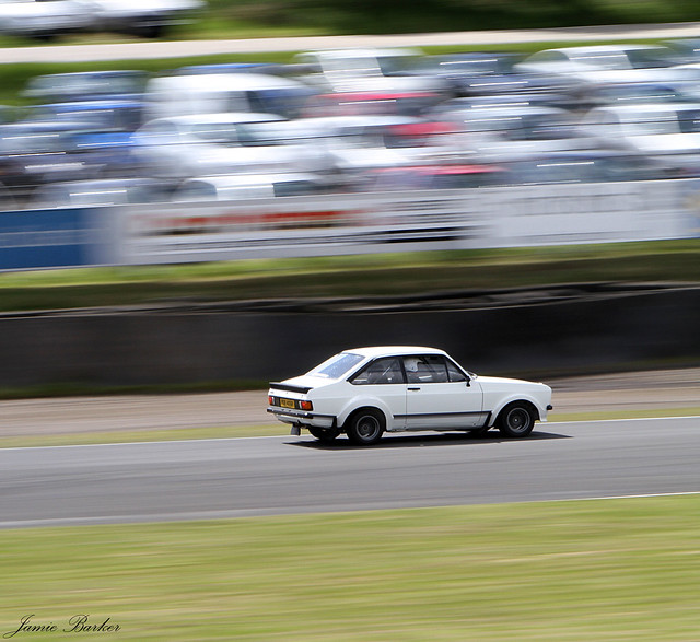

#3 - This is also the case with the other two, but worse on this one, the shot is spoilt by the cluttered background, if you are shooting that wide you really need to get the background blurred so that you can't tell what is there, cars/portacabins etc. The positioning in the frame on this one is much better though.
