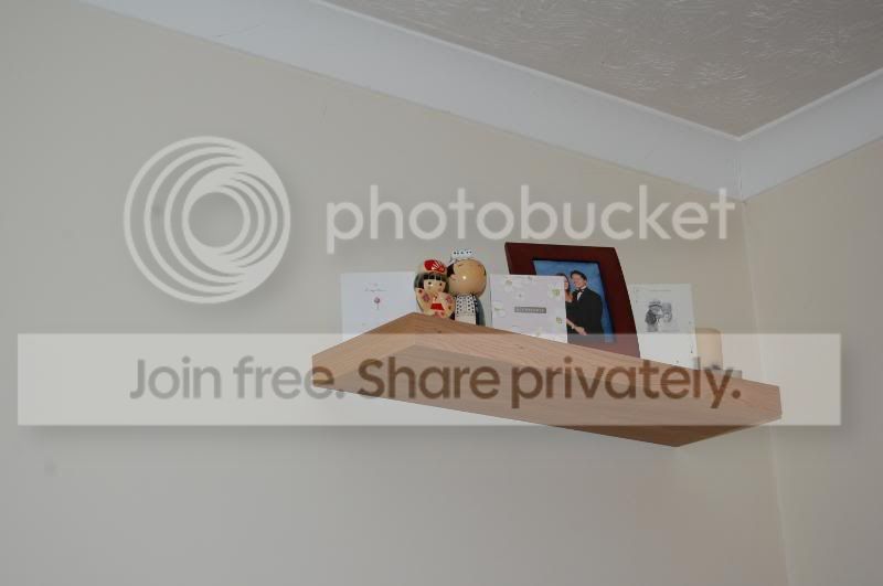

advice: my d40 pics have marks on them... with samples
2,391
i have two lenses and swapped them over to check it wasn't the lens. so it's the body.
you can notice two darker type shadow marks on the left bottom and left middle.
advice please, does it need a clean, service etc.?

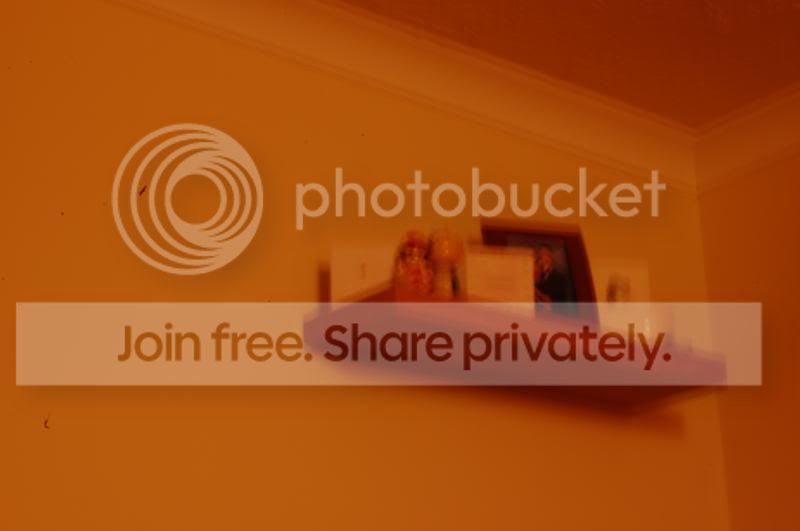

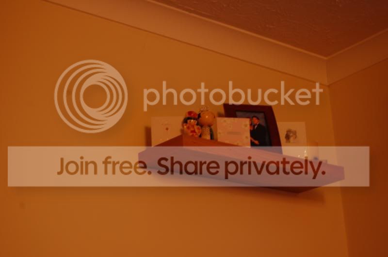

do you know how to change the APERTURE on your camera? IE, could you put the F number to the highest setting, take a pic of a white wall, and post it here?
Gary.
actually done...
