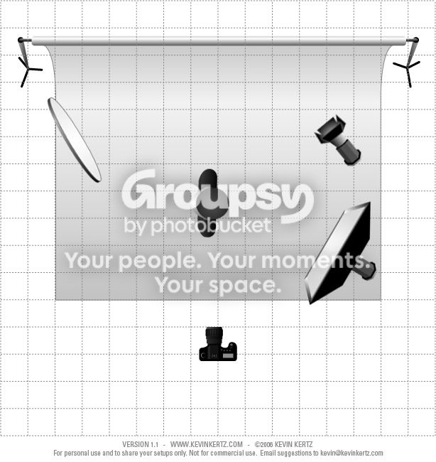

Try this set up.
The strobe to the top right is one of the d-lites with a softbox on but without the front translucent cover to try and act like a strobe with a reflector or barn door effect so as to fill the backdrop with light.
The reflector on the left will add light to the backdrop where the light falls away, because you only have one light.
The key/main light with softbox is on the lower right, just above head height pointing to the models left shoulder.
Firstly I would experiment with the background lights so that you can achieve the white finish you want.
Then add the model and try different settings so as to get the shadow correct.
If there is going to be only the two you present, tie the material in a knot at the out of frame side and then, attach some string to the knot and loosely tie it to the light stand, then the material should stay in the air. Be careful to try and not make the model move around too much as you don't want the light falling over.
It may take 30 mins after you have got the background right but I think it's a cracking idea and would love to see the shots after if the missus agrees.
Hope this helps.

Thank you so much for all of this, I was really beginning to panic there but now I have something to work to. I can't believe you went tot he trouble of making a photoshop setup tiler65...

I basically followed the advice and layout given by Tiler65, buggered around with settings and positions for ages as Garry suggested and then returned to the same format again. Using the larger of the two soft boxes without a difuser right up against the back drop at F6 did a fairly good job of making the background white although I had to add a reflector on the opposite side to get it truly white and wrinkle free. This caused a problem with there being just too much light bouncing around and it seemed to drown everything else out.
To combat this I moved the model as far away from the background as I could (about 7 feet) and pushed the hair light up into the air as high as I could go (about 10 feet) and used its lowest setting of F2 but I just couldnt seem to get rid of the overpowering light. In truth 'the studio' is our living room which is white with white furniture and a cream carpet so this probably didnt help. In the end I got rid of the reflector and treated the wrinkles in photoshop.... although my photoshop skills are pretty much limited to cropping and the paint bucket! If anybody has any in camera settings or trickery advice about what I could have tried I would love to hear it.
