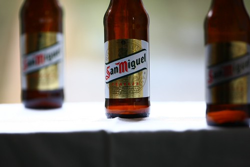

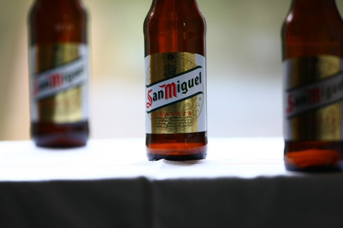

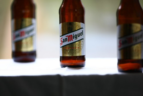

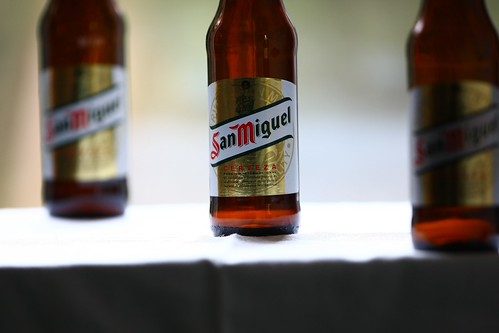

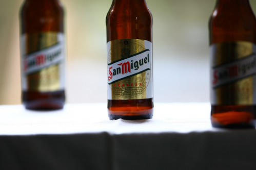

All shots taken on tripod, using AI Servo 2 second timer and remote shutter.
ISO 400 @ 400MM 1/125TH F/2.8 centre focus point, focused on the V in Cerveza writen in red.
Is this the right way to test the AF :suspect:
+20
+15
+10
+5
-5

Andy,
A couple of observations and opinions.....
Firstly, I'm not sure that using AIservo for a stationary target is going to tell you much about AF accuracy....I'd repeat the test using One Shot AF.
Secondly, I don't think that images of this sort are going to show you too much and certainly don't give the viewer anything to go by when they're presented resized for web viewing.
A decent, flat and perpendicular target shot at around 15-20m and then viewed at 100% will allow you to make a realistic assessment.
HTH
Bo
While this is correct, I have known AI servo to give me sharper shots than using one shot AF. My 450D just doesn't quite get it right sometimes - I always get best results using live view contrast-detect AF, mind you, and it's usually the only time when my pictures are tack sharp.

Something that I should have mentioned....
AF will probably have a tendency to show a slight back focus when used in artificial light (most sorts, at least). I make the assumption that your 400mm is an outdoor lens and hence should be calibrated in the same conditions.
Bob
This is as close as you'll get to Canon's official reference for AF microadjust. Taken from Chuck 'Mr Canon' Westfall's Tech Tips column here http://digitaljournalist.org/issue0812/tech-tips.html
Edit: the only bit I would quibble with is the 50x focal length shooting distance. This is right for shorter lenses, as this puts them into a normal operating range, as if you are excessively close, the lens has to move a long way to make small focus shifts and (unless it's a macro) it may not be mechanically capable of doing that reliably. The result of that is if you then calibrate the lens for good close up accuracy, it might be out at more normal distances.
However, 50x focal length on a 400mm lens is 20m distance and while that might be fine for motorsport or something, if you're into small birding your typical subject is quite likely to be less than 5m away. I don't have an answer for that, except to say that I would try and optimise it for the kind of distances normally used, within reason, but be aware of the potential problems and double-check it against a longer distance target and make the best compromise you can.
Having said that, if I had a spent £7k on a 400L 2.8 and it wasn't absolutely spot on regardless of where I pointed it, I would be very unhappy indeed :eek:
