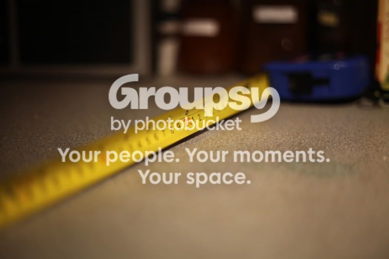

Battery test by Minnis Photography, on Flickr
Seems okay to me. I set spot AF on the centre AF point, aiming at the 4th AA battery along (6th in total)

The problem with the battery pic is you don't know where it has locked focus. IF the lens is out, it is only out a teensy weensy (technical term there) bit. With a curved surface at a reasonable distance, you won't know if it is out. The old cereal packet square on plus a slanted ruler is the order of the day.

Your tests are not sufficiently accurate, and neither are any of the alternatives suggested if you want dependable results.
The most likely cause of the back-focus evident in the pic of the lens is the hand-held camera moving a few mms after focusing. Camera has got to be on a tripod, the target must be flat, and the distance 'realistic'.
With anything other than a flat target, ie curved or angled, you cannot be sure where the lens has actually focused, especially bearing in mind the AF point is quite a bit larger than the little square in the viewfinder. And testing at such a close distance is liable to throw up errors that are not visible at normal shooting range.
AF calibration is a compromise and absolute accuracy varies acording to both focal length and distance. If you push it right to the edge of the normal optimum operating envelope by shooting abnormally close, you run the risk of making a correction that will actually make the lens worse at normal distance.
