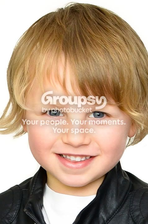

I'm really struggling with the focussing on my D7000, i simply can't seem to get consistently sharp results no matter what i try. I've even had it back to Nikon to get it checked out an they returned it with a clean bill of health.
This weekend i took some images of my son and all have come out soft to very soft.
I used D7000+Tripod+35mm @F5 + SB7000 TTL bounced from behind. Subject 8ft from Camera
Taken using AF-C to combat any small movement from my son who to be fair stood very still, i lowered the shutter to 1/40th to get some more ambient light in (i decided to blow instead in lightroom afterwards)
The 1st example has been sharpened a heck of lot to try and recover it and processed in lightroom.

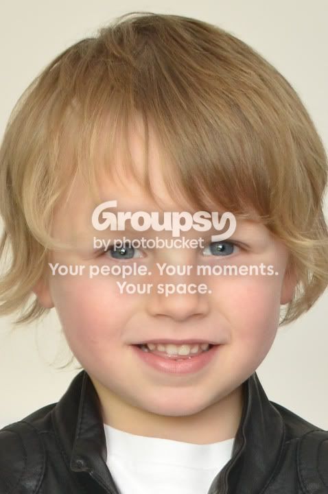

A Crop of the head shows the image still isn't in focus (check eyes)

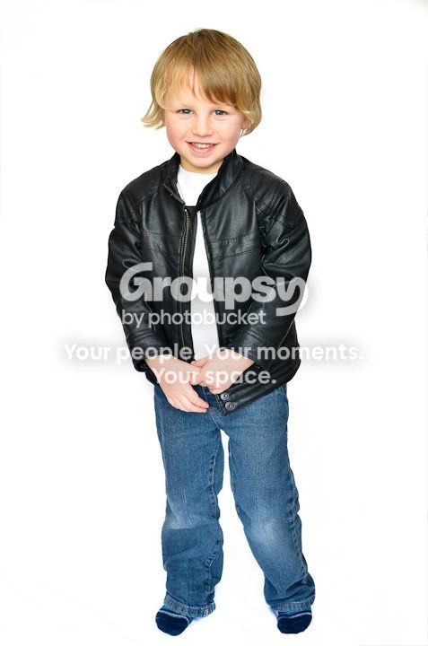

Finally another image cropped as it came out of camera.

1/40? Why???! You are definitely getting motion blur in there (He is moving!). With flash it is nice and simple 1/250s. As it's too dark, increase the power of flashgun till you get the right exposure in camera, rather than pulling 1-2 stops.
The crops don't seem incredibly out of focus (some blur yes). Where are you focusing - the eyes?
this - the eye blurring looks like motion blur, not out of focus. I always try for at least 1/160 with portraits generally to prevent that 'blinking blur' especially when using flash as blinking is more likely.
Yes, movement blur rather than out of focus. Could be subject movement or camera shake - both are likely at 1/40sec with a bit of ambient light about.
