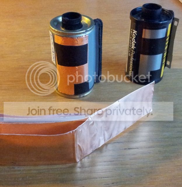

I've got a couple of charity shop point and shoots which don't let you override the film speed. Being a natural born cheapskate I make my own DX labels using self adhesive copper shielding tape like this (no connection to seller, lots of other sellers on ebay)
http://www.ebay.co.uk/itm/EMI-COPPER-FOIL-SHIELDING-TAPE-SELF-ADHESIVE-/271407817489?pt=UK_Sound_Vision_Other&hash=item3f312aa311
Here's some of the tape and a reloadable cassette set to 400 ASA next to a standard Tri-X.
Just put the copper on first and blank out the other bits with insulating tape. You can make any speed you want, look up the patterns here:
http://en.wikipedia.org/wiki/DX_encoding
The tape's only just over a pound per metre.
