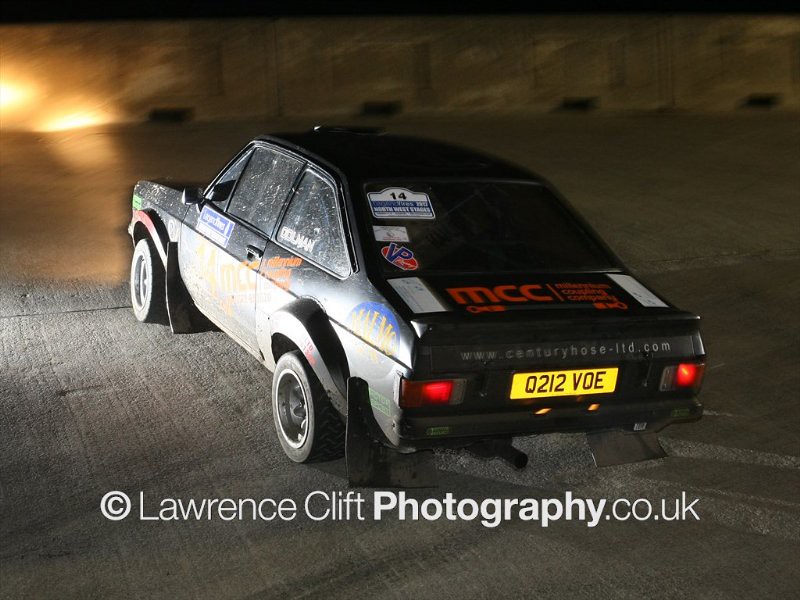

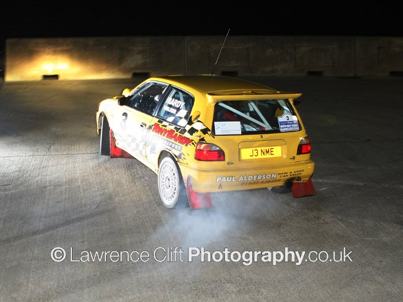

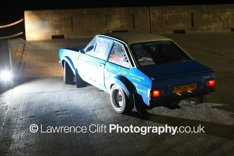

I bought a Seculine Twinlink kit last week and used it in anger on the local NW Stages rally a few days later. Even though I was accredited media, the marshall's only allowed me to return to the flash unit and adjust before the stage went live twice, and it was a no no to return to the flash whilst the stage was running so I wasn't able to re-adjust.
My question is, Even though I was shooting at comparatevely low shutter speeds (1/60 & 1/80) there's no real movement in the images. Should I have also used 2nd curtain sync? Also, the cars were taking different lines around the hairpin, thus I had a few shots that were blown out. The flash was set in manual at 1/64 and 24mm.
Thanks for any feedback.
