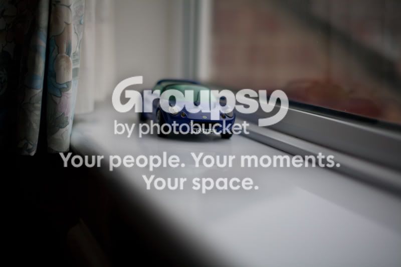

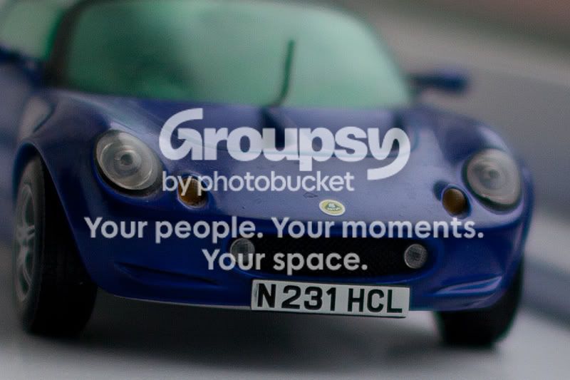

I have one of these, I don't think it's razor sharp at f1.4 and on bright subjects you can get some blooming... anyway, just shot this little test for you...
Whole image with focus on "23," hand held.
100% crop...
