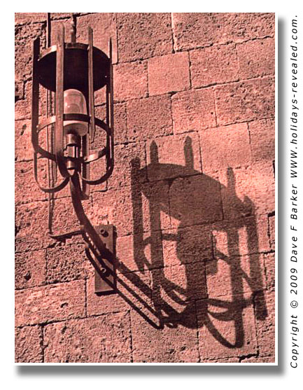

Hi
I used to like doing, B/W, with Lithe processing and lithe Printing on Lithe paper, then Selenium toning, fabulous colours, oranges, greens, pinks :thumbs: from what should be black and white, This is the only image I ever scanned and unfortunately it doesnt show the green and orange tones as I was carp at scanning, basically coz it was a cheap scanner, 10 yrs ago, taken in Rhodes town Rhodes in 2000
