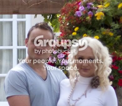

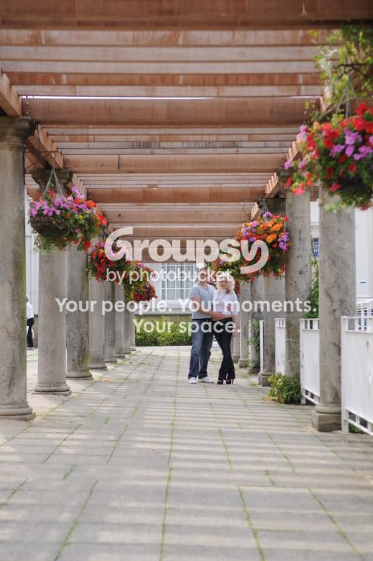

The images below are just 2 of the oof shots from yesterday.
The first one you can see that they are soft in the image, however the flowers between their heads are pretty sharp. I'm hoping that the focus point was between them and on the flowers.

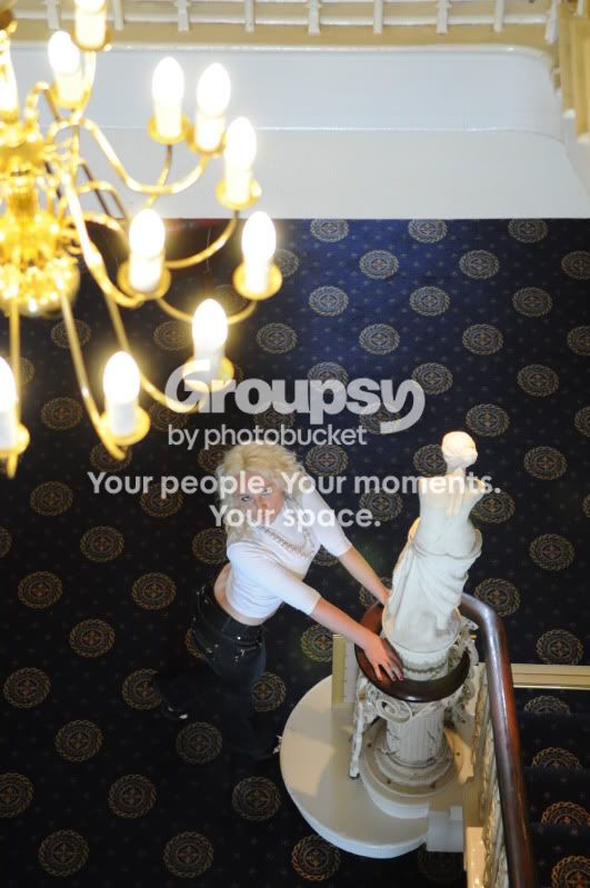

This one the image is sharper on the carpet behind the subjects head. Again, I hope I focused incorrectly. Seems strange though as I don't normally miss.
Easy to see that it could be user error there, but those are not difficult subjects to get right - centre AF point, standard focus-recompose technique.
If it's out, it will be out with every shot by an equal amount.
Assuming you were using a single centre AF point, you can see what the probable problem is with this one....

You definitely need to eliminate all possibility of user error before you begin to suspect a problem with AF adjustment.
Yep, I'm using single point but I normally focus and recompose. I've checked and the camera is set to AF-S.
I just checked the images in the Nikon software and can see the focus point is away from the subject in hand. However I guess it just highlights the selected focus point rather than the item that was selected, so i'm still none the wiser as to if its user error or not.
Yes, it just shows which point was used, and with focus-recompsoe by definition that won't be much help.
But as I said before, if it's out, it will always be out - by the same amount, in the same direction, every time. Try a couple of test shots. I just posted a suggested test target on another thread, here post #5 http://www.talkphotography.co.uk/forums/showthread.php?t=340760

There's no problem with focus-recompose technique for those images - none at all, even if the subject was well away from the chosen focus point, which actually it isn't in this case.
Focus-recompose is only a problem at very close distances and very low f/numbers. At normal range, it is better because the centre AF point is more sensitive.
What I suspect has happened here is that the AF point wasn't actually over the subject when the focus was taken, and has accidentally picked up on the background which is immediately adjacent. The same danger would exist even if another focus point was used.

I'm not saying it's the cause of the problem with these particular shots., but MarkG the OP does say the sharpest part of the shot in the first image is the flowers between the two heads, but it's strange that the flowers on the other side of the walkway in the same plane certainly aren't sharp - in fact I'm inclined to think the sharpest part of the image is that window frame in the bg which is slap bang in the centre of the image.
I'm not saying we should draw any firm conclusions from this, but certainly focus/recompose shots aren't the best to try to resolve this. Mark needs to put that AF point over a spot, keep it there and take the shot - that way we'll have a better idea of if there are any AF issues.

In the case of the OP, the problem is compeletly unrelated to focus-recompose technique per se - the AF point has simply fallen on to the background immediately behind the subject. Basically, user error.
