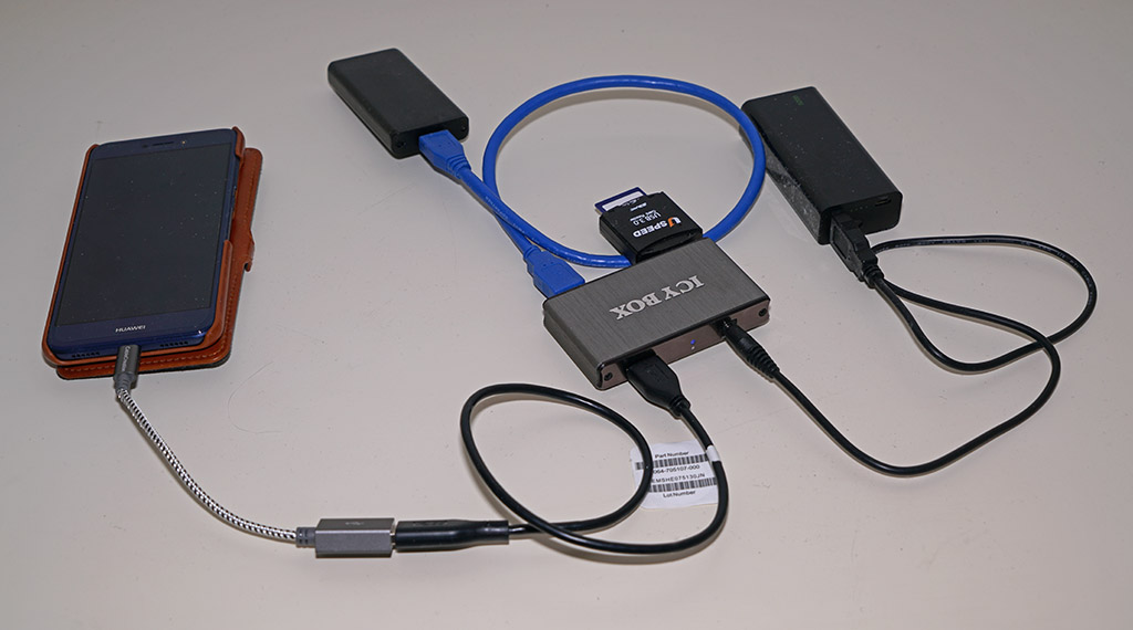

I've done this, just to prove it works. I used a USB 3 hub, card reader and external mSATA drive. The phone's connected via On-The-Go and USB cables and the black lump on the right is a power-bank to drive the whole thing (except the phone which won't charge through an OTG cable). The drive needs to be formatted as exFAT rather than NTFS or the phone just doesn't see it. I only needed to buy the OTG cable as I had the rest.
Thanks all. I don't want to take the DSLR with me to avoid spending all holiday with it. Plus that gives me an excuse to upgrade my compact to an RX100 before I go! Thanks Snapsh0t that's exactly the solution I was looking for. I'll try to find that type of hub. Although you've all got me thinking about more SD cards now...!
That hub's quite old so new ones might well be better and there seem to be plenty of them at sensible prices at e.g. Scan. I have a strong suspicion that if you went for a large Flash drive rather than an HDD/SSD then the phone would power the lot so you'd have a much neater package.
