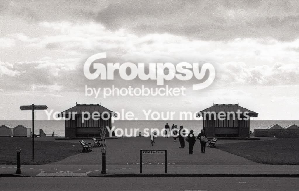

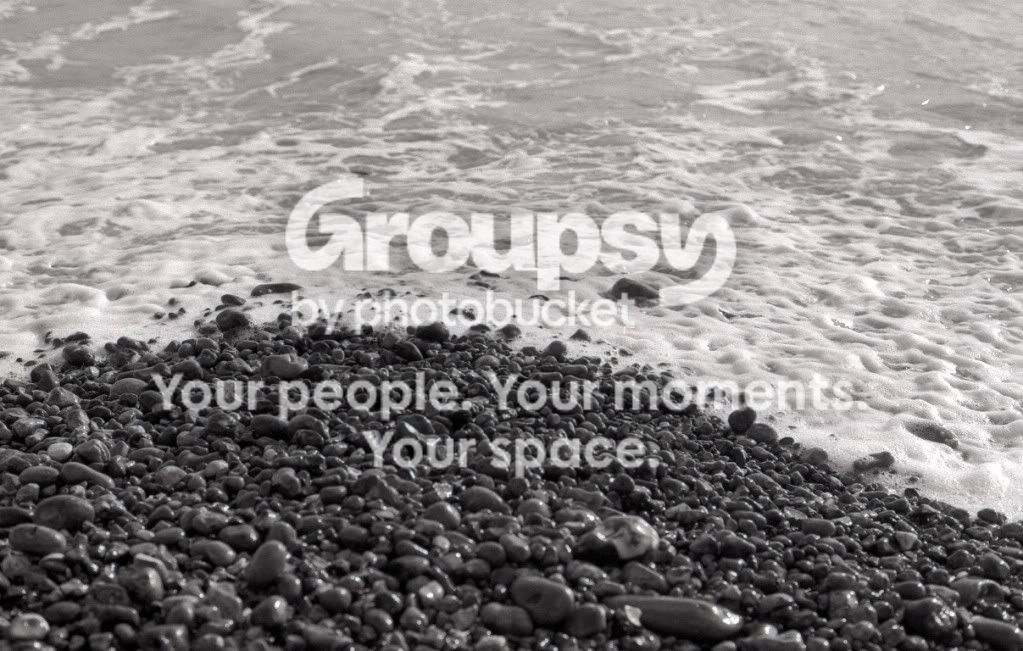

here's some pics with white in. They do pop a little, but not in a bad way imo, the sky in the first pic was pretty boring on the day and I was surprised how much detail it got out of the clouds. Again in the second pic the whites are quite bright but not at the loss of any detail

Timreeves, are you sure that much detail is lost on the negatives too?
My Epson scanner regularly insists on clipping pale shades and on some films I need to adjust the histogram before it scans on every single frame. It's amazing, it looks like highlights are bleached out, and you think "fair enough, that part was a lot brighter", then you manually adjust the tolerances and all sorts of detail becomes visible.
Technology is far too smart for it's own good.
