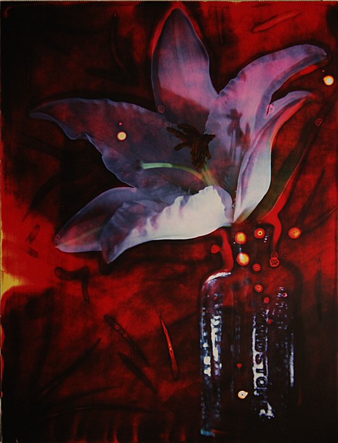

here we have a bleach process. This time, on the print - so , no negs harmed in this one :LOL:
Oh , and this time I have the foresight to say -
if you have nothing good to say, then be good, and say nothing :D
This is the result
Photographic Paper Bleaching - Homework by Tricky!69, on Flickr

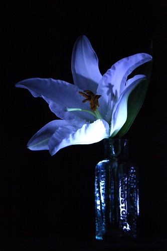

This was the original
Home work by Tricky!69, on Flickr
Thanks Deckard :)
Digitall, the second shot was just a means to an end. Quite normal - anyone could do type shot.

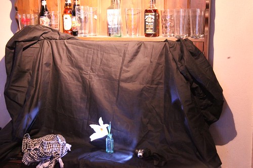

Setup here, if anyone is interested.
Welsh dresser - black sheet - couple of poundland led tourches.
Homework setup by Tricky!69, on Flickr
I really like the bleach version as well, the colours and odd marks make it look and feel very arty

Like that, a lot :) Remember seeing the effect back in the 70's :confused:
I like this (y)
Not sure that I prefer it to the original (Even though you say it was a means to an end I think that is a very appealing image too) - Both are very different takes on a theme.
What I find so interesting about this though is the method of creating it. It's so easy to think that all these filters and arty effects were created by Photoshop - this is a nice little reminder that a lot of these techniques existed long before then.

How does this technique work?
Really like the red treatment, would look awesome on the wall.
Thanks
The print is a wet chemical / exposed photo paper print - i.e. a photo - not an inkjet print.
The bleach, softens the print colours/chemicals in the paper, which are in layers.
The blue washes away 1st, then red, then yellow. you need to practice, as the bleach keeps working after you are done, and rinsing ! You have about 2 minutes working time, before you need to start rinsing. Bleach dilution is about 20 water : 1 - household bleach
This one is 12x16 and was mounted and hung on the wall in our college 'Art week' exhibition.
