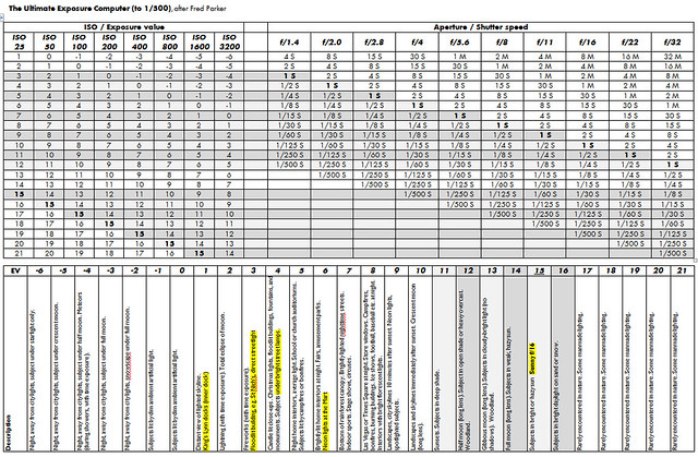

You can get away without a light meter, there's plenty of latitude with Pro400H. A near-enough exposure will give a scannable result, bracket +/-2 stops if you're unsure.
See the Ultimate exposure computer.
Yeh Fuji is incredibly easy going, I've used 800Z at 100 and it was fine. In fact that film performed best as a 200! If in doubt err on the side of overexposure and you'll be fine.
