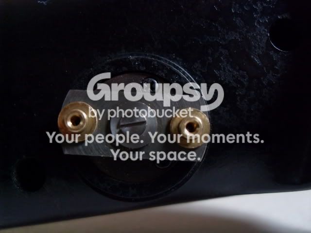

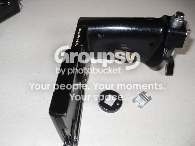

... I realised the 2 screws holding the grip-to-body winding crank winder were loose. I stupidly decided I'd tighten them 'later' and forgot about them until I went to take the speed grip off again when the winding mechanism fell off the speed grip! Basically, I want to know if anyone knows what size the screws are? I've looked all over the internet and can't find the information anywhere and it's not in the manuals either. Tomorrow I'm going to trawl round opticians and make my way to Sid and Jane in Warwick to seek help there too.
TL;DR: What size are the screws for the holes in the pictures?

If it's of any help, the screws that hold the M42 lens mounting plate to a Zenit E body will work perfectly for the winding crank on your grip.......length, diameter and thread are spot on!
I did get it sorted in the end, I took it to Clock Tower Cameras in Brighton who replaced the screws and recalibrated the grip tension (or so they said, anyway) for £2! But that's certainly good to know, and hopefully if anyone has the same problem and does a google they'll find this thread :D
