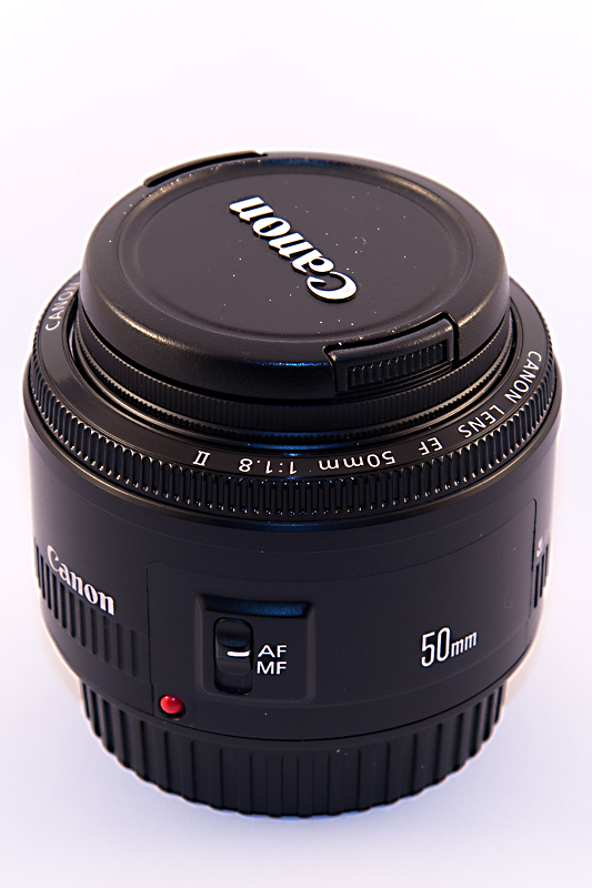

I have built a lightbox with 2 500w halogen lights pointing inside it, but when i fire my pop-up flash it makes a blue reflection, how can i stop this?
here is an example.
