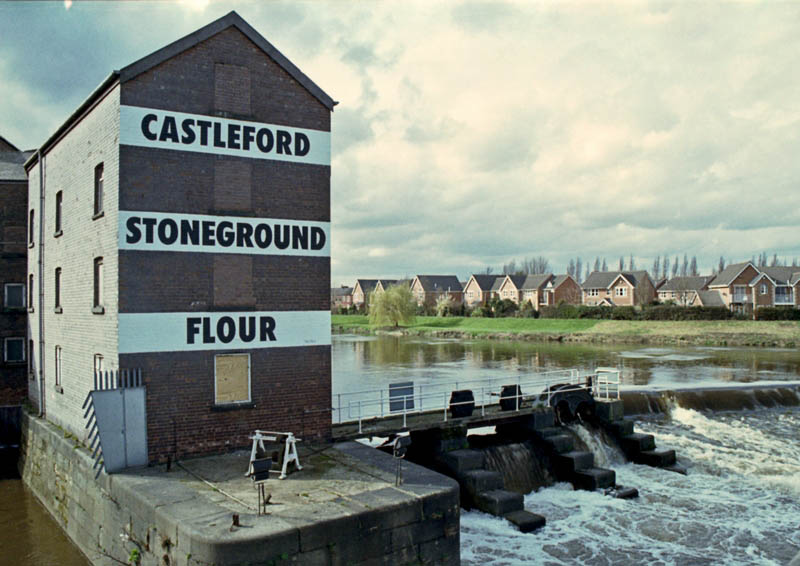

Well - i'm still struggling a little with the Tetenal Kit. Followed the instructions to the letter with last reel, only to get washed out colours, and a slightly milk-ey negative. Bumped the processing time (hopefully to boost the colours) and time in the Blix (cure the milk-ey look) by 30 seconds extra. But they still came out a little washed out and with a blue-ey caste... I'll be damned if I let it beat me though :)

Allinsons Mill, Castleford
Both shots are pretty much straight from the scan, square crop on the daffys, and a tiny amount of high-pass filter sharpening (as I didn't sharpen in the scanning software) Rather than mess about with curves etc, to get rid of the blues, I'll keep on working on getting the developing right instead :shrug:
I'd be happy to get that BY - even if the daffs are too yellow :D

Looking at the neg's, compared with a commercially processed film, my film has definitely a deeper brown caste to the base areas, so it's looking like another 30 seconds of BLIX. I love using the lemon method* of photo processing :)
