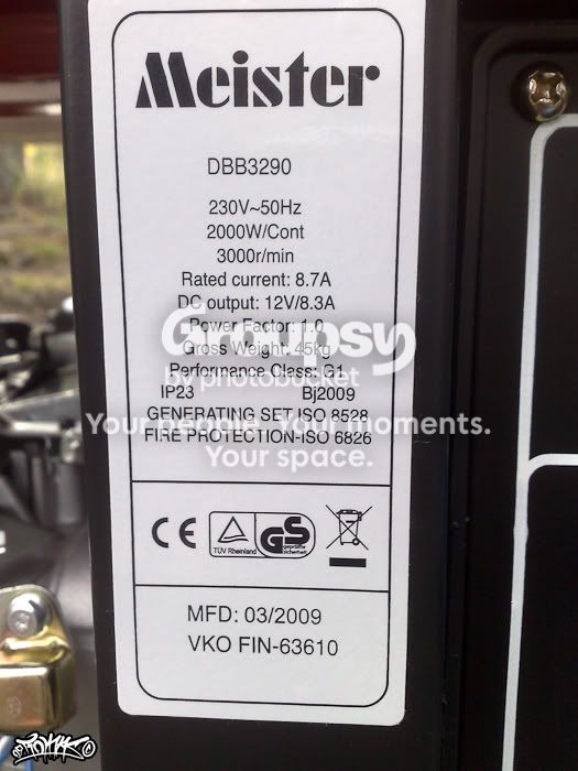

UPDATE.
It appears the pure sine wave is also a generic necessity with generators as well as battery packs.
It also appears that most gasoline/petrol powered generators are pure sine wave but I'm unsure whether my investment is :thinking: However, one can apparently get over that hump with 'a power cleaner'. A surge protector is also highly recommended.
In addition, not all monoblocs or flash heads require pure sine wave apprently, some will run successfully from a square wave output.

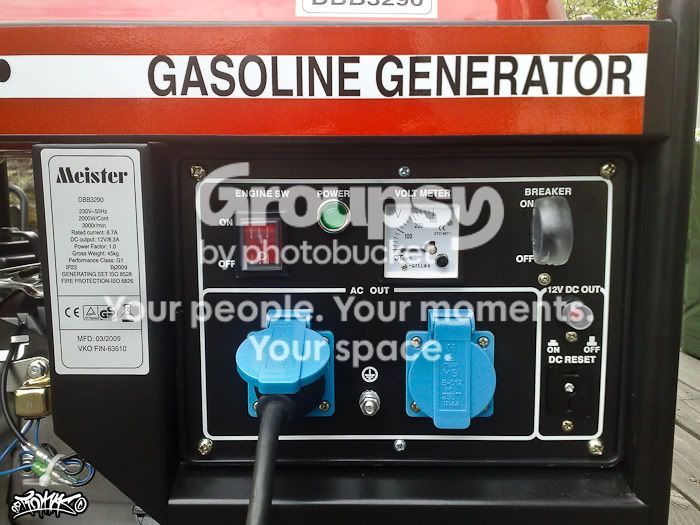

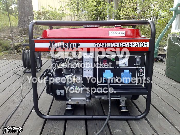

That's very kind Guv, although I think Big Mike (my gennie) is in the 'clean power' gang :D.
This is a test from a short while ago (nokia N95 vid :gag:). The 3 x 500w halogen lights are purely to add more balls to the test, at the moment I only have 2 Elinchrom d-lite2's so we needed to run a test with more wattages.
After the flashes fire, the gennie makes a short 'catch up' kinda noise, but I'm told that's quite normal.
[YOUTUBE]<object width="480" height="385"><param name="movie" value="http://www.youtube.com/v/XaqhPkVCCm0&hl=en&fs=1&rel=0"></param><param name="allowFullScreen" value="true"></param><param name="allowscriptaccess" value="always"></param><embed src="http://www.youtube.com/v/XaqhPkVCCm0&hl=en&fs=1&rel=0" type="application/x-shockwave-flash" allowscriptaccess="always" allowfullscreen="true" width="480" height="385"></embed></object>[/YOUTUBE]
Due to the frame rate of the vid, it looks as if the flashes aren't firing but they are. All is as it should be in that department.
Before I hear the 'that's SO loud' comments, I know it's not quiet at CLOSE proximity but on an actual shoot Mike the Meister will be be at least 20 meters or more away from the set where talking volume is not affected :lol: ;)
Here's some nasty N95 pics too
All seems well really, I tested this out for around an hour and a half and even gave it harsh going over in terms of heavy repeated flashes, the recycle times were precisely the same as using a conventional AC outlet too.
Bare in mind, I can run studio lights all day on less than 30 euros of gas. Battery packs, with any brand of lighting, will need recharging a few times in a day. Considering the price difference, which is enormous, I'm pretty pleased so far.
My ideal set up will be either a 600ws or 1000ws main light and 2 400ws side/rim lights for starters. Modifiers ranging from a 170cm octabox (arrives monday) and two 120cm softboxes when the funds allow.
Rest assured, if anything does explode, I'll let you know, but I assume that would have happened already.
