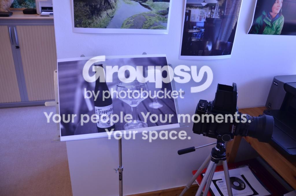

I have a cheap but nice and easy to get on with tripod but would like to convert it to quick release, I can't replace the head its part and parcel, is there such a thing as an adapter that screws i to the standard mount but has a removable plate that can stay on my camera?
Its mainly used with my Mamiya RB67 just to add.

looking realy to keep the cost down, I do like that type of clamp but cannot find a budget version, my tripod only cost me £5
This is the camera and tripod
