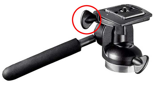

I have a Manfrotto 055CL tripod, with a Manfrotto 390RC2 head.
The problem I am having is when I try to mount my D7000 with MBD-11 grip and 80-200 f2.8 lens.
I attach the quick release plate to the tripod mount on the lens, but when I try and put the QR plate back onto the head, the front edge of the camera grip catches on the tilt lock on the head.
Here is a pic showing what the grip catches on.
Any-one suggest a head which will work for me with this camera/grip/lens combo please?
Thanks in advance,
Gary

@RKC- yes, there is an arrow, but that is not the issue, in other words, it makes no difference which way round it is, I have tried, but thanks for the suggestion.
The problem is that the lower front edge of the grip protrudes by quite a way, and this is what is catching.
I could turn the head around, and use it backwards, which would only be a temporary cure.
This is the joystick head : http://www.digitaldepot.co.uk/tripods-1/tripodheads/manfrotto-222-joystick-grip-action-head.html
This is the other head I use. I've had no issues with it : http://www.digitaldepot.co.uk/manfrotto-804rc2-tripod-head.html
I use a D300/700 with the 80-200 f2.8 using either.

I have seen the joystick type heads, but wasn't confident they could support the weight of the camera with grip and a heavy piece of glass like the 80-200.
Think I will check it out at my local camera shop.
