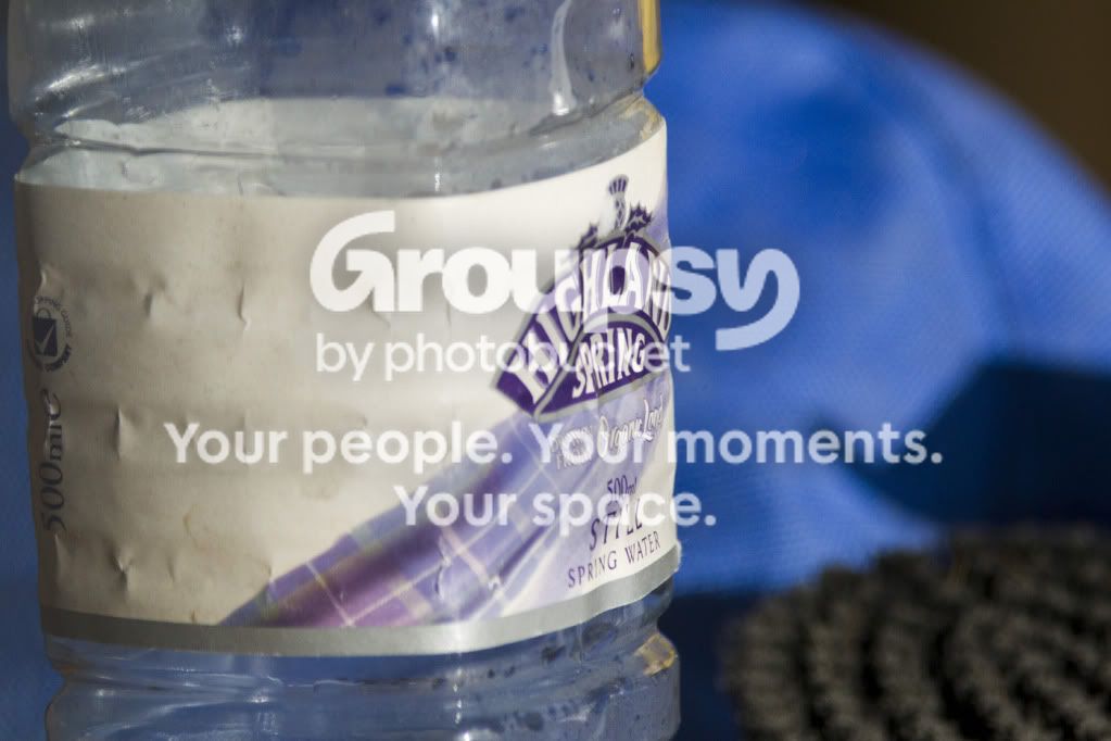

200% crop and Full frame
Canon 600mm @ 1200mm f9 on an 1DIV
Um, that's quite good...
Have you got a shot with the Mk II for comparison?
Do not have the MKII but I have a Kenko 2x DGX that I tested against the MKII and found it sharper so I will test the MKIII against the DGX when the weather permits it and I have some free time for a more comprehensive test.
I am very happy though with these first shots and I find it perfectly usable at f9, barely improving at f10 and f11.
I would be happy with those too.
One day, that sort of reach will be mine too!
Did you manual focus (I am guessing you didn't have to, as the lens should have been f8, stopped to f9)
If you didn't manual focus, are you happy that the focus wasn't in the centre? (which Is where I would assume you would aim for, for a test shot)
(Damned good though. Wish I could afford one (and the lens (and the camera )))
As I said, it was just a quick shot as soon as I got the TC.
The shutter speed was 1/3200" and I had IS on so believe me, there was no camera shake!
Have a look at my other thread when I got s sharp-ish shot at 1/13" at 1200mm and you will see that 1/3200" is more than adequate :)
