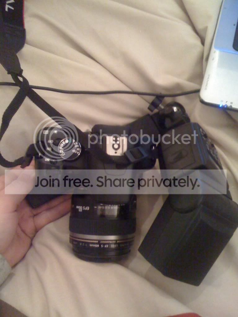

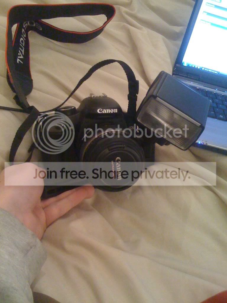

Right, just testing out a new macro set up, with the on board flash and a flashgun on slave, but the camera doesnt seem to be registering the slave flash only the built in flash?
any advice

its all rigged up on a metal bar for my marco work for when out and about, I wanted the built in flash for trigger the slave so i get a more general light coverage. The slave is rigged up nearenough on the side of the camera...if that makes sense?

I use this gun in manual 99% of the time for my macro, i've just got the bar in the pictures above to save me hand holding the light and camera together, so the triger from FITP works perfect for what I use.
