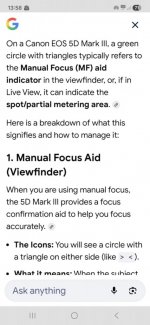

Issue - Won't take photo and now MENU, INFO + Q buttons do not bring screens up on the rear LCD. It's all a bit weird.
I have repl;aced the small CR1616 with a new battery, taken the lens and SD card out and tried to hard reset it all... but the issue is it just won't take a photo... in auto focus mode the green dot with brackets pops up in the viewfinder... if i put it in manual mode, just the large green circle... I have no idea what is going on...

Based on the info above - if the picture fits what you're seeing, check the contacts on the camera & lens (does it happen with all lenses or just that one - if it happens with just one lens, check the lens; if all check the body)
Blindingly obvious question though - you haven't set the lens (or body) to manual focus have you?
