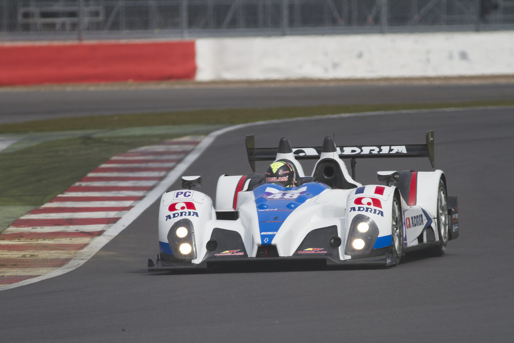

ETTR (Expose to the right) is good advice too, I always err on the side of overexposure with the 7D. This was ISO100 with the 70-200 Mk2, shot RAW with no noise reduction applied at all:
This one did need a fair bit of noise reduction but still not bad considering it was at ISO3200:

Vertigo1 - Nice example. What is the hi res like at 100%?

Still pretty good although not pin-sharp due to my lacklustre panning skills :)
It looks like over sharpening to me?
Like an orange peel effect.
Turn the sharpness down and see how you get on.
Possibly. I just set the picture style the same as the 550D as the sensor is the same. I guess with the processing it could still be different.

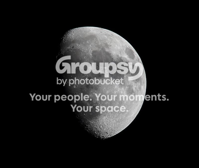

certainly is interesting, not a car as I don't have my motorsport images on my laptop but a bird from today.
To put this into context this is shot at 1600iso and a fair crop too.

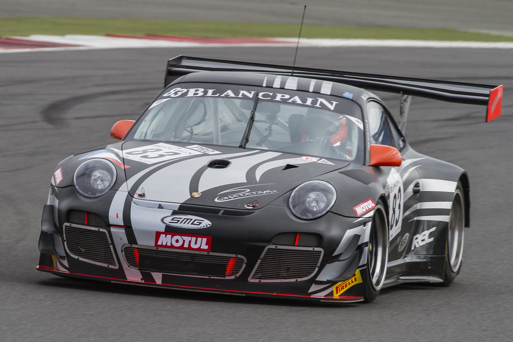

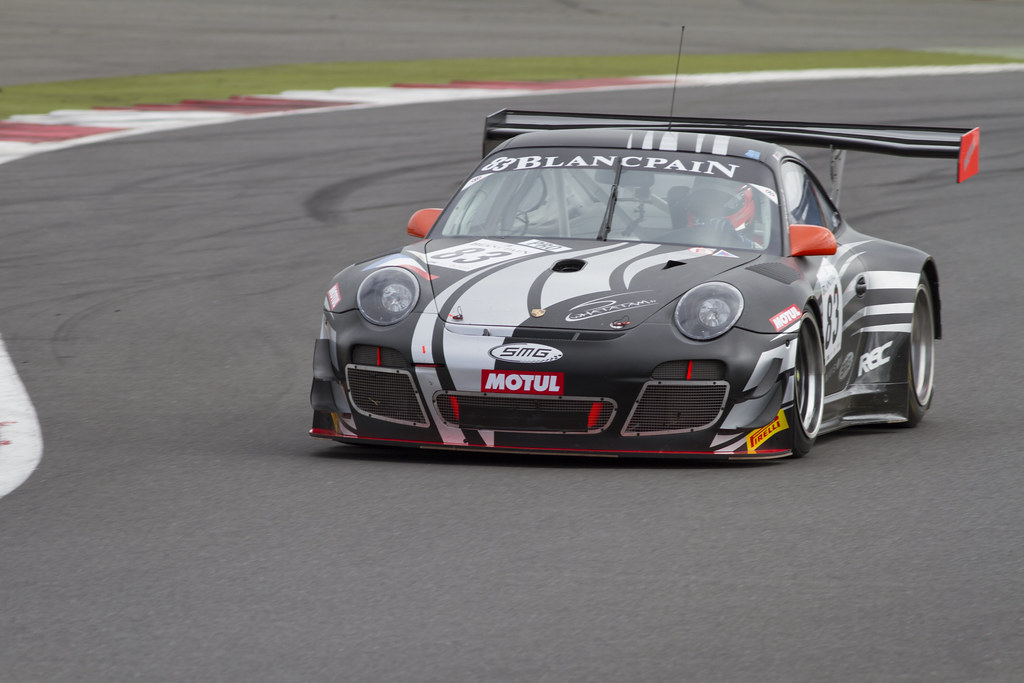

Who can guess what image came from the 550D and what one came from the 7D? Both pictures taken with the same lens (from memory) Either way the 7D image was taken with 70-200mm f/4 L at 200mm and the other image was either the same lens or the Sigma 150-500mm
They may well have been taken with the same lens, it's also very apparent they were taken under vastly different lighting conditions.:)
Stew.
Stew.
This.
If you've only had the 7d out in that crappy light, unless you shot them side by side you're comparing apples and pears.
On my soap box again, but photography is about the subject, composition and light, the gear is a long way down the pecking order. If you shoot in crap light you get crap pictures - that's the same whether you're shooting Sebastien Vettell with a 1dx or banger racing with a 300d.
