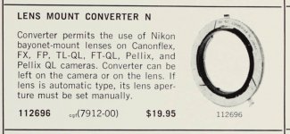

Spotted this on the internet...
So since this adapter for Nikon lenses stops the lens down I think it's a fair guess that the P adapter does likewise.
