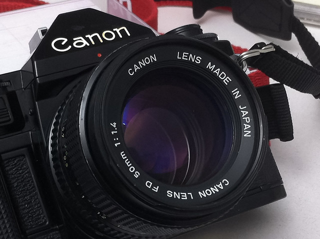

Do you mean the FD 50mm f/1.4, like this one of mine on one of my A-1s? :)
Recent Arrival by cybertect, on Flickr
