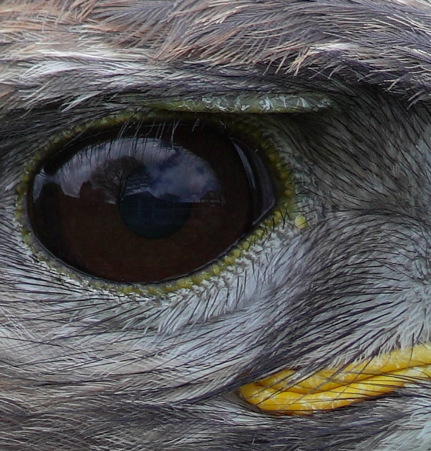

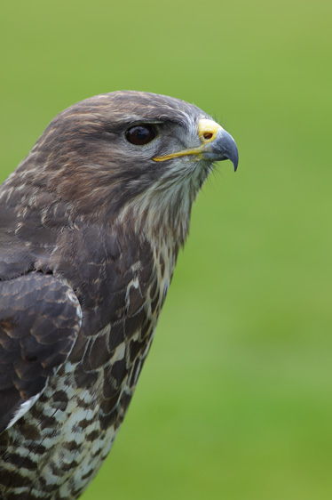

This is a false theory that is mentioned quite often. Today's high-res cameras like the 5D2 capture so much detail that far more care must be taken when using them to ensure sharpness at 100% magnification. You can't rattle off shots on a 5D2 or D3x like you used to on an old 1D and expect perfect sharpness every time. The detail captured by today's cameras shows up every minor defect when viewed at 100%. In my opinion, cameras like the 5D2 need to be treated with the same time and consideration as medium format cameras. If you know what you're doing, cameras like the 1DsII & 5D2 capture astounding detail.
To illustrate this, here's a shot I took a few months ago. I admit the photo is nothing special but look at the detail in the 100% crop. These images have not been played around with. If you look extremely closely you can just about make out my own reflection in the eye of the bird! Now do you see what I mean?
100% crop from above image:

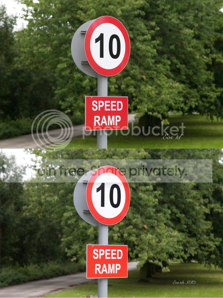

Comparison pics
Taken at F8 200asa on the 24 - 105L lens at 105mm
stew

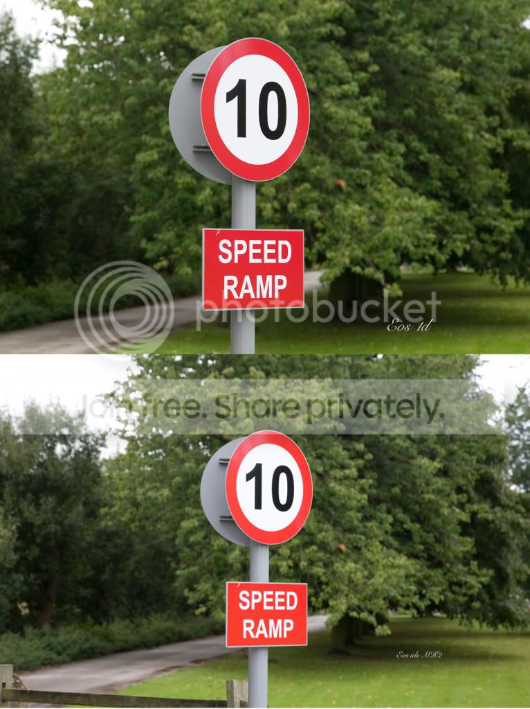

Same photos but I have enlarged the full frame image so the speed sign is a similar size
At these sizes it is hard to tell any difference. The only way is to shoot two identical shots and post 100% crops from each image. If you're shooting RAW then each shot would need to be processed exactly the same.
Also remember that the 1D has the advantage of shooting through the sweet spot of the lens because it doesn't have a full frame sensor. In theory that should mean better quality at the edges of the 1D images. In reality that may not prove to be true.
They look very similar, and there are no fine details in the photos. You may wish to try something with fine texture or small details, like brick wall or some city scenes. And definitely shoot RAW.

In that case I'm with daugirdas. It is very hard to see any difference. I'm at work at the moment using a crappy monitor.
Are you absolutely sure they are both crops at 100%? When you say the first pair were full crops do you actually mean full frame?
Look at my pictures of the bird. The first shot is the full frame, the second shot is a full crop (at 100%). We need to see full crops from each camera.
what do you mean as full crop? I have taken the whole image and cropped to 20inch at 300dpi so I could see it on screen. I then cropped the whole image to 1024px - the maximum the forum allows.
The biggest difference I see is in th edetail on th ecobweb under the speed sign - the d1 has more detail and the green is greened in the D1
