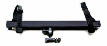

For less stability, but more flexibility, suspending the camera from the lens foot is a great option. But it requires a car with window frames or a gutter. This is one example (the Lens Sling I make/sell, but it's a pretty easy DIY).
And this is the Window Rail I make/sell which is based on HD pocket door hardware (200lb). Which is the best option for panning; but still reduced stability.
I wouldn't recommend anything that clamps to the window directly; it's not particularly stable and it's not designed to take the load vertically or twisting. Early on I used a Kirk window mount which is currently the WM-2 model, and there's the Leofoto WN-03 which I would probably like better than the Kirk. But I prefer the other options.
