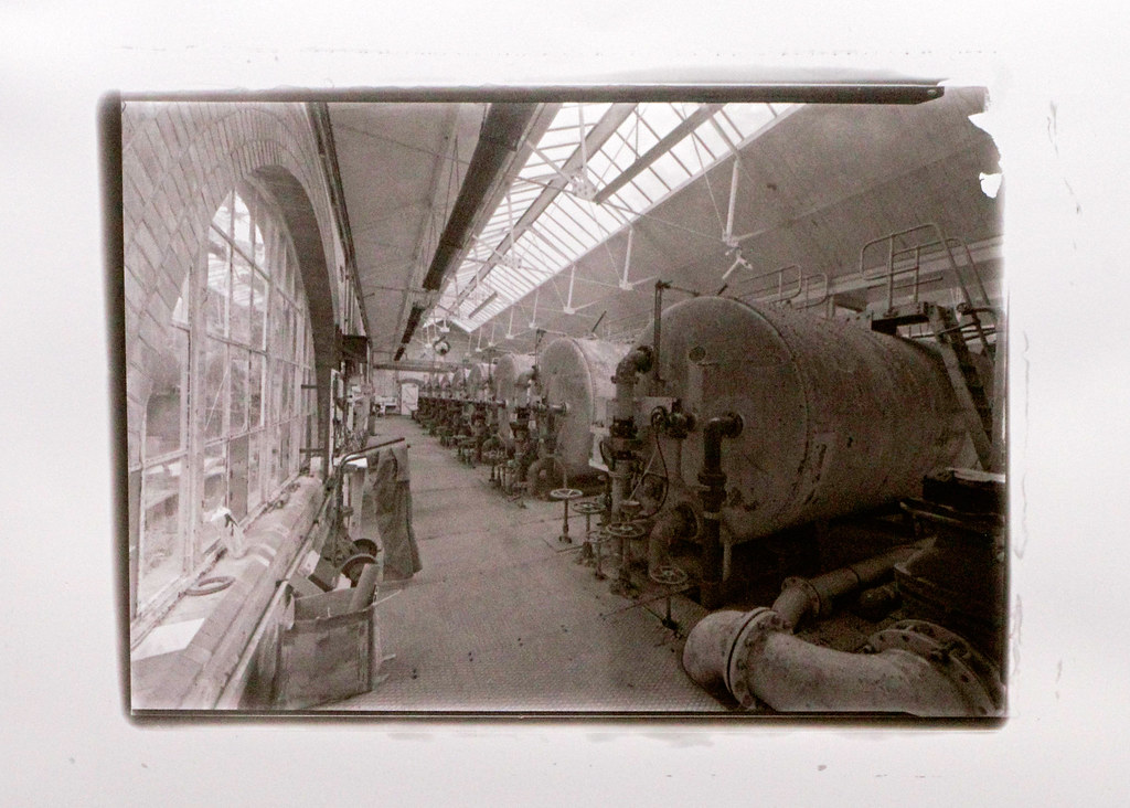

Carbon Transfer Print
I like that a lot Ed, the process suits the subject very well. Timeless :thumbs:
Thanks Nick.
Made the actual image yesterday and after a couple of 'not so good' attempts I managed to get a good one with relief, it gives an almost 3D effect with great depth.
Carbon 3
by Ed Bray, on Flickr

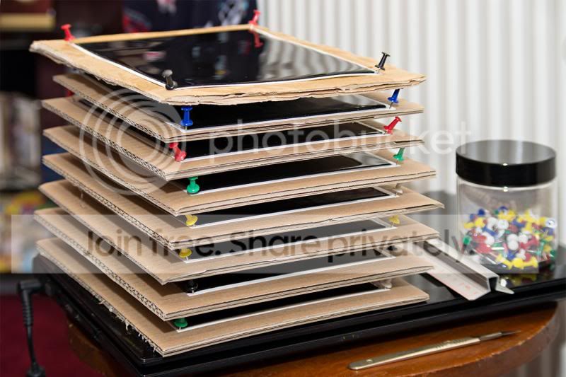

My latest batch of tissues, just after pouring. They now have to dry for 2-3 days before I can begin sensitising them.
wow.

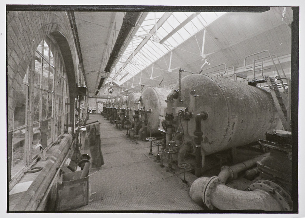

Latest attempt, digital image of 5x7 Carbon Contact Print taken with a Pentax K5.
Thanks for sharing...I love seeing such alternative processes.

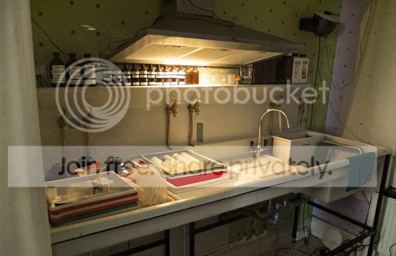

Not posted much lately, been a bit busy converting the darkroom to a more Carbon based structure.
Sink now fully plumbed in, with 3 sets of hot and cold (one as a mixer) and an additional cold for a wash tank. The 1 metre wide cooker hood for fume extraction has another benefit, it houses 2x 25 watt tungsten bulbs which give a great 'carbon safelight'. I will be making a short hardwood draining board to fit between the wall and the deep well of the sink. I am also going to mount my CPP2 in the window (currently covered by blackout material but that will be replaced by 3/4" ply. When the Devere 507 eventually goes I will mount an Air Conditioner high in that corner with my film (and tissue) dryer underneath it.
I've just got the soft rubber flooring to install and I will move out the LPL enlarger and mount the UV lightbox in it's place.
I took the opportunity to make some more tissue, this time 2mm thick.
I might even have a printing session tomorrow :)
