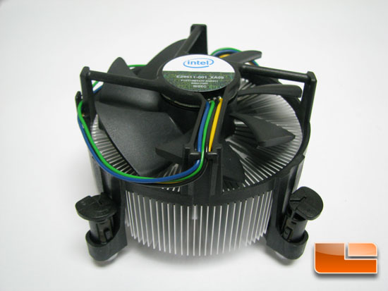

Gman, apologies for hijacking your thread - awesome looking computer Btw - but can someone tell me whether the CPU fan should be blowing cool air into the heat sink or sucking hot air out. Does it matter?
I would have thought you'd want to suck the heat that the heatsink has absorbed away from it? My stock CPU Heatsink and Fan pulls air way, you can tell from the side that the wires are on:
