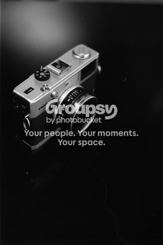

Here is an example or two of what I achieved with the above.
Thats a similar sort of idea I had with buying 2x 467 flashguns but I didn't factor in the umbrellas into it. Atleast I know that works and its a pretty damn cheap idea.
Light tents are not a good starting point, basically they're the tool of choice for ebay sellers and the like who just need bland lighting that shows what the product looks like, without any creative input. It is actually possible to produce reasonably creative results with them, but it's making hard work out of a relatively simple job.
The question really is what do you want to photograph and what sort of results are you looking for? If flat, bland lighting is all you want then a light tent will do the job, and you can use daylight for it.
If you really are on a tight budget and already have hotshoe flash guns then they're usable, but far from ideal - the limited power, lack of a modelling lamp and lack of effective modifiers doesn't make them ideal. This thread is well worth reading, and there are also at least two other threads below this one that address the same issue.
Using hotshoe flashguns (or any other type of light) with shoot through umbrellas will give you much the same results that Dean posted above. If you're happy with flat, bland lighting with no shadows then fine, but if you're not then you need to use lighting tools that define the shape of the product and show its best points. This doesn't need to be complicated, for example this shot was taken with just a single light

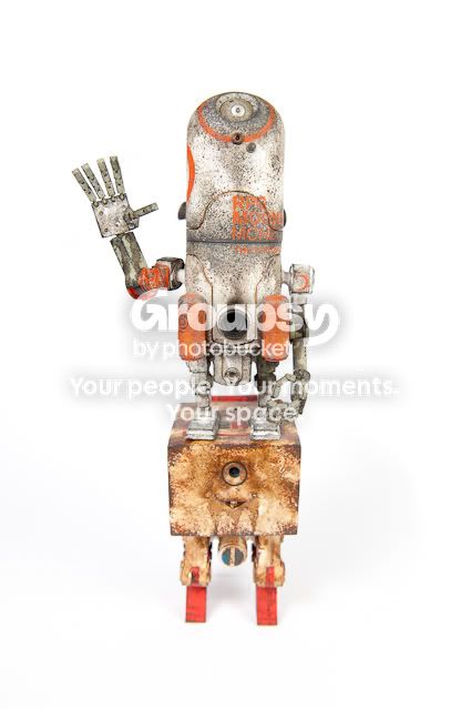

That particular shot involved
1 x ElitePro flash head
1 x 70 x 140cm softbox
1 x boom arm (to support the flash head in the right place)
1 x 5 in 1 reflector.
There may have been other bits and pieces, but these were the essentials.

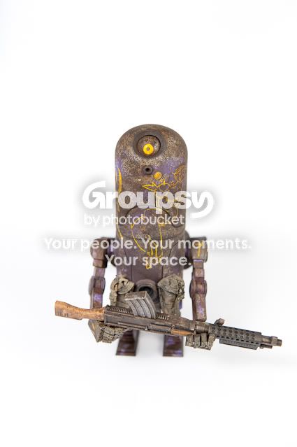

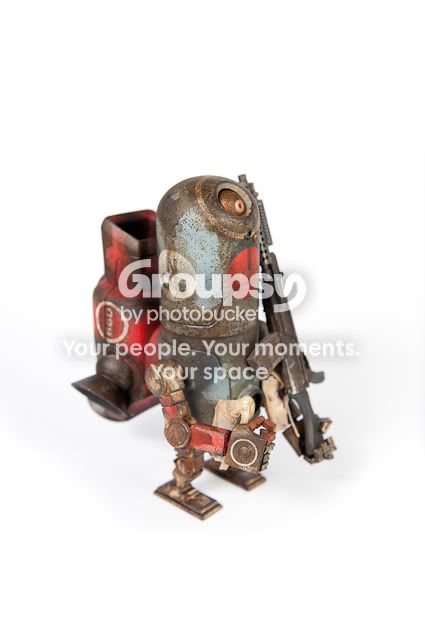

Its arrived and all set up so thanks to Garry for chasing it with the delivery company. Trying to work out how high I need the soft box and what power I need to get a black background on my product shots. Any ideas into these "settings"?
You need to tell us much more about what you're photographing...
At the moment, very small items such as shells and even a faberge egg. I've go the soft box very low, just out of the frame and the results are more pleasing than I would have hoped so far. Just tweaking them though to find out where I need to position things in the limited space I have in the room I've now turned into a mini studio at home.
I'll put on a sample in a few mins so you can see what I've been doing. How did you actually turn the background fully black with your photo Garry? The highest my 5D mk ii will go with shutter speeds is 1/200 without getting the black band starting to appear (at 1/250 and above). So far I'm shooting at around F10-11 and have the head with the soft box on at around 1/8 to 1/4 power with just the initial button pressed for the light. I still need to sit down and work out what the other buttons do incase I'm missing something essential from the head itself!

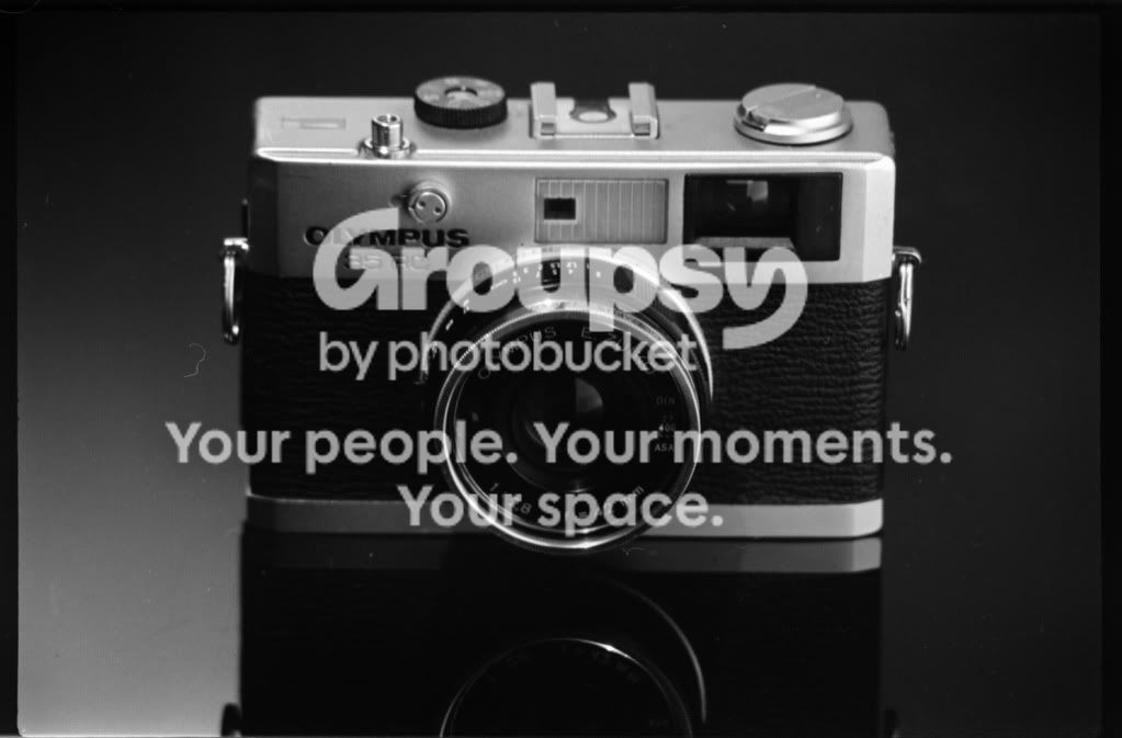

My lighting arrangement is fully explained in the blog entry.There are some major differences between the way I did it an the way that you've done it.
Firstly, my product base was a piece of 'black glass', a smoked glass table top, this produced a reflection of the subject, and apart from the difference in the visual effect, following the principle that the angle of reflectance equals the angle of incidence, the light from the overhead softbox bounced off of the glass at the same angle as the angle at which it struck, which means that it didn't light it.
Secondly, my camera height was much, much lower. You're looking down from above, which has created perspective distortion and also an out of focus area. But it has affected the amount of light visible on your product base too, because it's showing much more of it, due to the higher camera angle.
So, your background isn't really a background at all, it's a product base. My background is a white wall behind the subject, it doesn't show as white because no light is reaching it. This allows for the background to be lit separately (if required) as in this shot
Where a blue gel over a second light has added the background light.
The shutter speed isn't relevant. All that you need to do is to make sure that no light reaches the background (which isn't possible when the background is in fact the product base) or to use a background/product base that either reflects almost no light at all (black velvet) or which reflects a lot of light (glass) but which reflects the light away from the lens.
That isn't relevant either, what matters is the ratio of light (the amount of unwanted light that reaches somewhere it shouldn't) not the quantity of light. This is fixed and isn't related to the power setting of the light.
Understood, I'll try and source a base that allows reflections properly. All I've got at the moment is a few stone plate mats which do reflect but have a rather harsh pattern on them. I did a quick test shot at a vastly lower angle and see what you mean as even that starts to show avery nice and clear reflection.
Yes, camera position is vitally important and makes a huge difference. Just experiment with various surfaces that you have lying around.
I'm more than happy to give advice, but you'll learn more/quicker just by experimenting, once you have a good grasp of the principles.
Yeah definitely. Struggling to find some suitable materials so I've been looking for something suitable online. The photos I've taken so far have all been accepted by stock websites without any issues so I'm at least happy about that lol.
I'll keep trying though.
