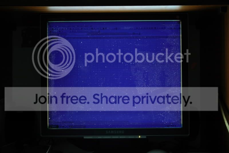

Also interesting is that LCD screens give out a polarised light which can be cancelled out by a filter. I used it here to demonstrate just how filthy my screen was:
