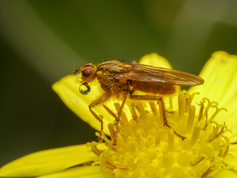

People are sometimes surprised at the image quality you can achieve with achromats. I use them on general purpose zoom lenses, which are in general of lower quality than prime lenses. I use them with small sensor cameras, which compared to dSLRs capture small amounts of detail and suffer from a lot of noise. The sensors on my bridge cameras are about one twelth of the size of the sensor on an APS-C camera. Nonetheless, even with this unpromising arrangement I find I can get sufficient image quality for my purposes (viewing at 1100 pixels high and printing A4 or occasionally 16x12).
Here are four examples, captured with achromats on, respectively, a (2007) Canon S3is bridge camera, a (2009) Canon SX10is bridge camera, a more recent Panasonic G3 micro-four thirds camera (with a sensor about three quarters of the size of an APS-C sensor) and a Panasonic FZ200 bridge camera. All were captured with the smallest available aperture (f/8 for the bridge cameras and f/22 for the G3) so as to maximise dof. The price of using such small apertures is very significant loss of detail, but for my purposes, taste and standards, I am content with the detail in these.
EDIT: Incidentally, the first three were captured as JPEGs, which of course provide less information to work with than RAW images.
(To see larger versions click on an image and right click on the image that comes up. The "Original" size is 1100 pixels high.)
0505 5a IMG_5489-Edit-4 PS1 PSS3.75
by gardenersassistant, on Flickr
0505 2 IMG_4374-Edit-2 PS1 PSS3
0505 1 P1460054-Edit-2-Edit PS1 PSS3
0505 5 P1040035-Edit-2 PS1 PSS3
