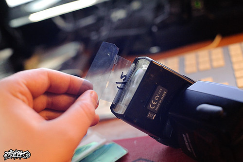

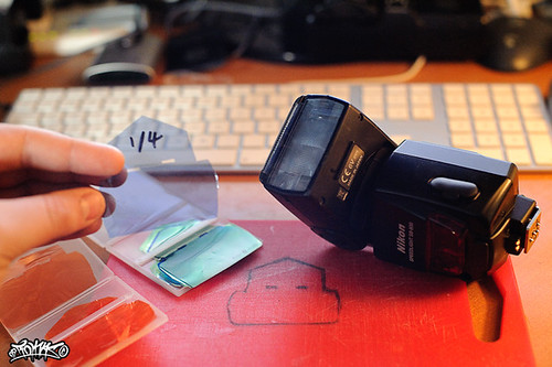

Unfortunately buying sheets of correction gels by either Rosco or Lee Filters is the way forwards in terms of selection and flexibility. The range is just too vast and then there's the specials etc.
Stofen do make some omni-bounce type things that are coloured for flourescent and tungsten correction but it seems variations in temp are very limited.
I cut all my gels in a similar way to the freebies gels that came with my SB-800, never ripped a gel or had to see fit to toss one in the rubbish either.
No velcro needed and all your diffusers, modifiers and stofens aren't hindered in any way when attached or fitted. :thumbs:
Make sure the fold is scored tight or the gel will flap away from the flash head, the two small rectangular holes really help with this tight scoring.

I think for the time being I'll aim to knock up some gels that attach to the flash a' la Tomas' photos (thanks for posting the images - very helpful) or some to sit inside the sto-fen (cheers Jason).
