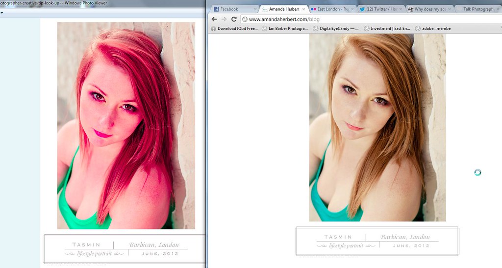

Hi all,
I calibrate my monitor everyday [in desperation] and have checked the colour space for LR / photoshop etc. However, my monitor is now showing day glow red for all colours in that spectrum.
Old photographs processed with perfect skin tone are great once uploaded on the web, but are ridiculous when I view them as jpegs or png on the monitor.
Google throws up other people having this problem, but I've not found a solution at the mo.
Do I need a new monitor [it is 2 years old] or has anyone a neat solution for me? Fingers crossed, Mandy
Example:
I'm having monitor problems - any ideas? by M@ndy, on Flickr

Images that have been processed a year ago successfully via print or web are now viewed as day glow on my monitor. This means, images I know are 'colour correct' are viewed as orange on my monitor. Once upload on the web they are 'correct'.

Straight upload onto flickr:
flower by M@ndy, on Flickr
Screen grab of how the colours are interpreted by my computer:
ScreenShot002 by M@ndy, on Flickr
