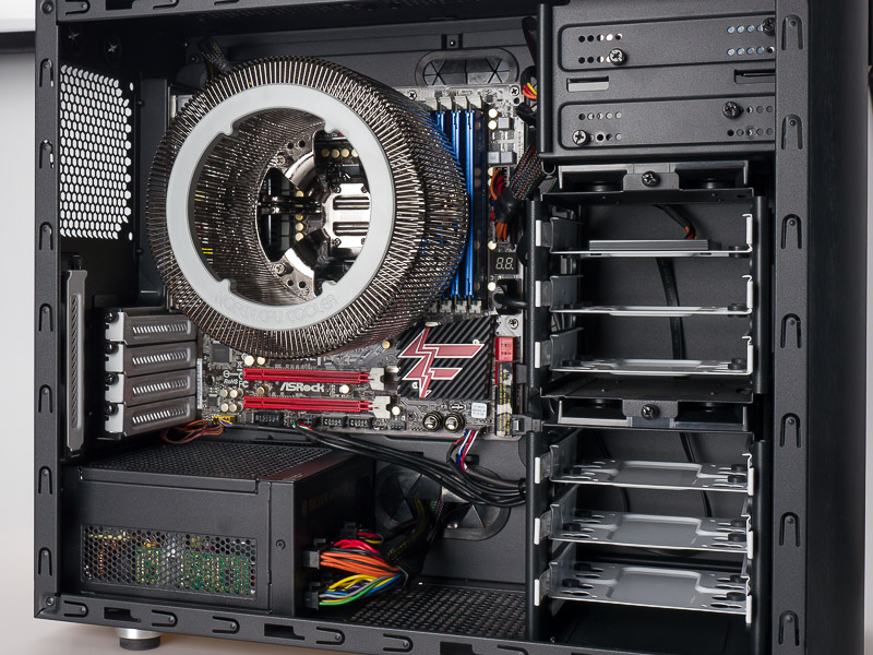

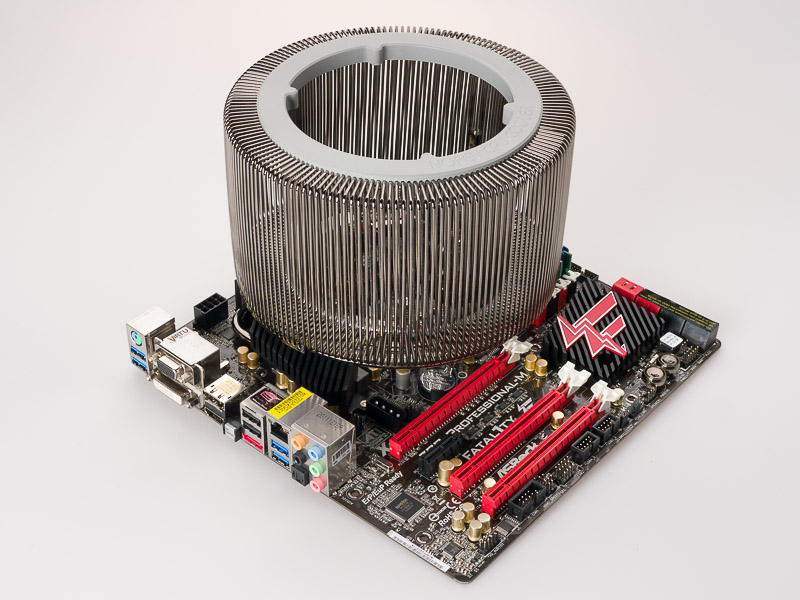

Well... I'm officially impressed (apart from the fact it worked when I plugged it all together :D). Firstly, it is silent which is weird. Turning a PC on with NO noise - silence. Very weird.
I have a 65W TDP processor and whilst I am running it in a case with the side off, I have had it running prime for the last 10 minutes. It maxes at 3.2GHz (which is correct according to specs) and the CPU cores are running about 40 deg C. That is INSANE....

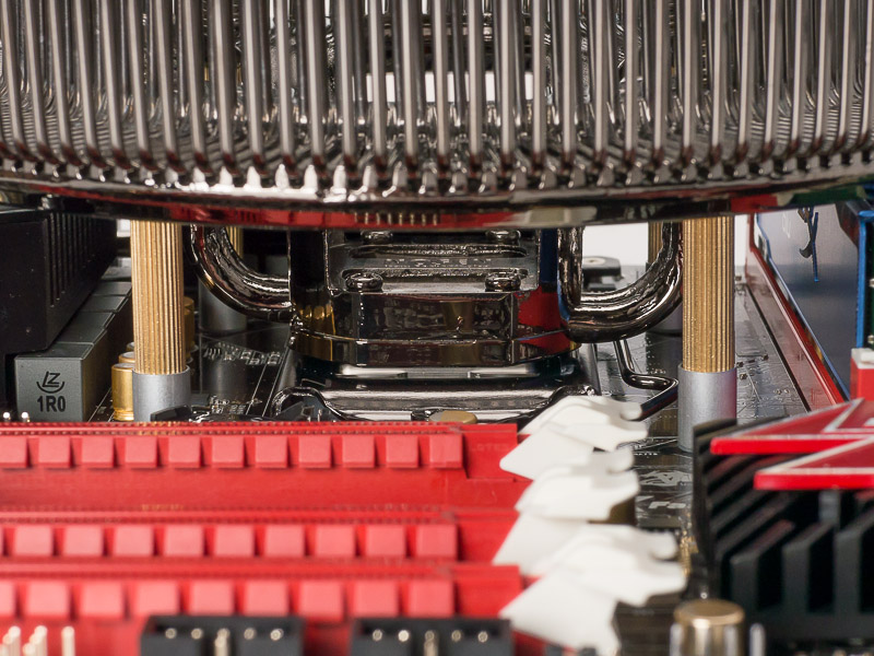

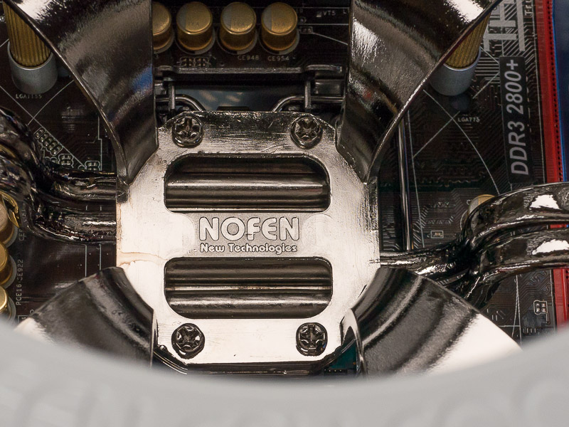

tsk... just for you...
Try reloading............. They work here and are on an external server...
Looks like a bad card, half to a third of some photos are a nice battleship grey:eek:

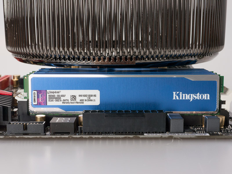

My too late comment earlier was about RAM stick space and it certainly looks like a cooler removal job if any go wrong.

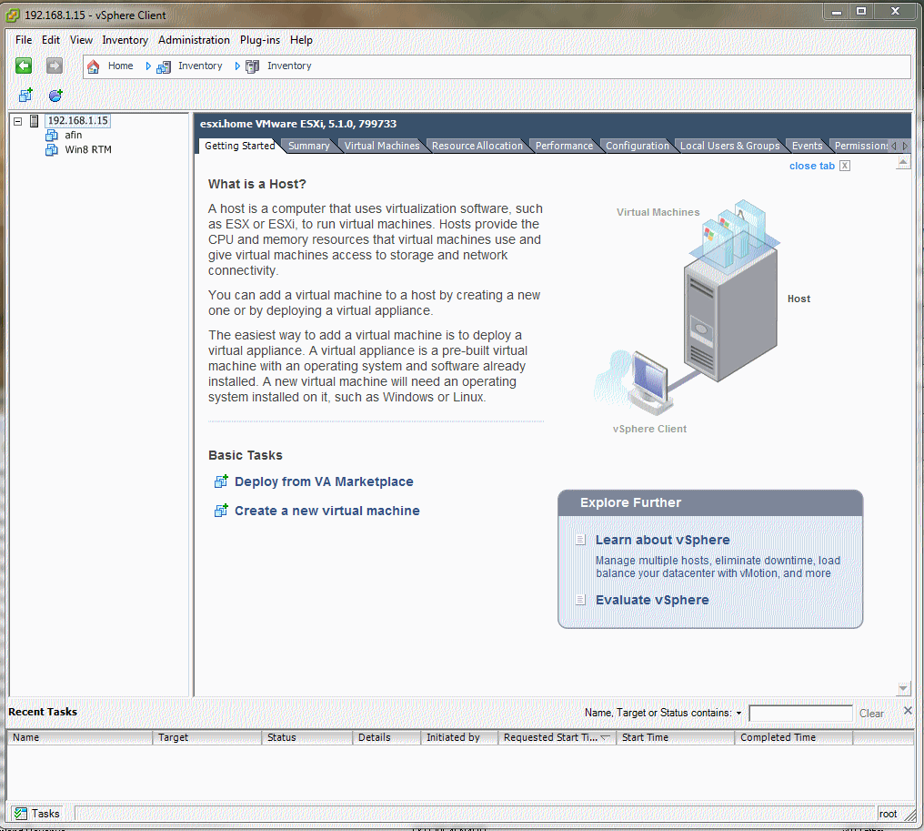

got my hyper-v running last night and VM installed for IIS.
VMs rock.
This is where it's at...
Basically, I can mark any of these as "passthrough" to a VM. That is, they appear as if they own the device and see it as if they were on the hardware with no hypervisor sat in the way managing the hardware.
Pop a RAID card in -> pass it and a network interface through -> run something like OpenIndiana and you have a bare metal fileserver.

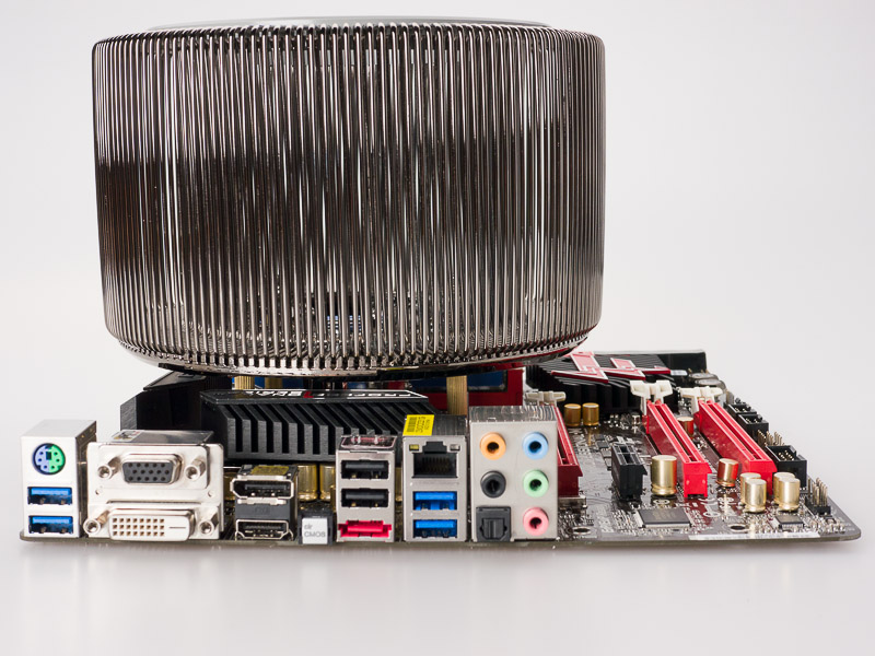

I should have bought a full sized ATX board to be able to plug more cards in!! The first PCI-e slot is unusable due to the heatsink and the second looks dodgy for use (but may be OK with a half height card in).
BTW: for anyone going to try this, I couldn't get the onboard network card recognised for the management network "out of the box" so have a server network card in the chassis at the moment (HP NC380T - £25 from e-bay)...
