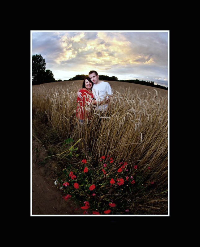

Oh look, I copied you :D 'xactly the same plan - drop the sky a bit for drama, light the front. Shoot in a place that Uncle Bob won't get anything like :)
Lit with a Safari to camera left. IIRC all we had to hand to soften the light was a shoot through brolly (this was an impromptu bit between church and reception. Exif says we were in the field for 3m 15s and we had problems with the PWs. My brand new assistant was looking a little shell shocked...)
